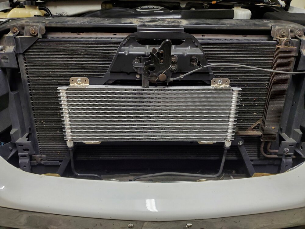

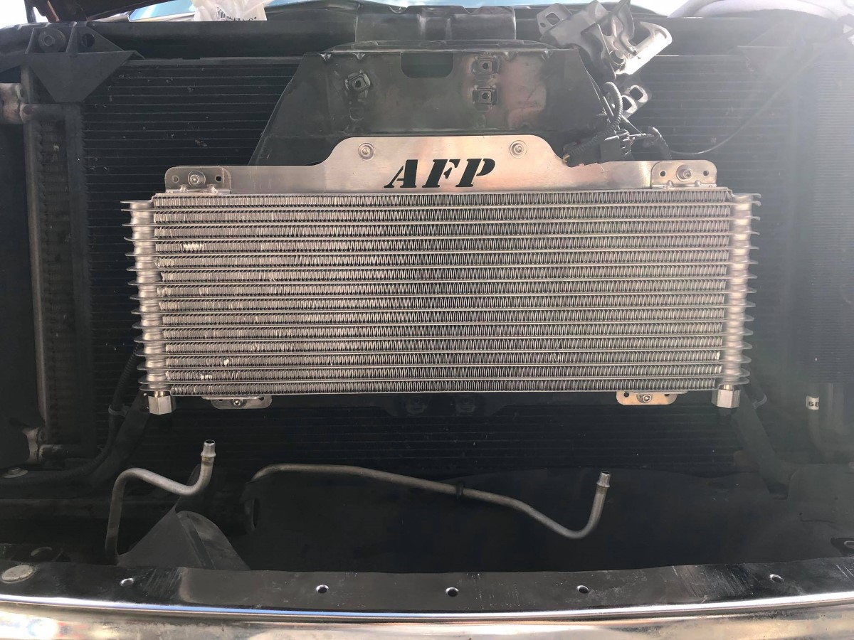

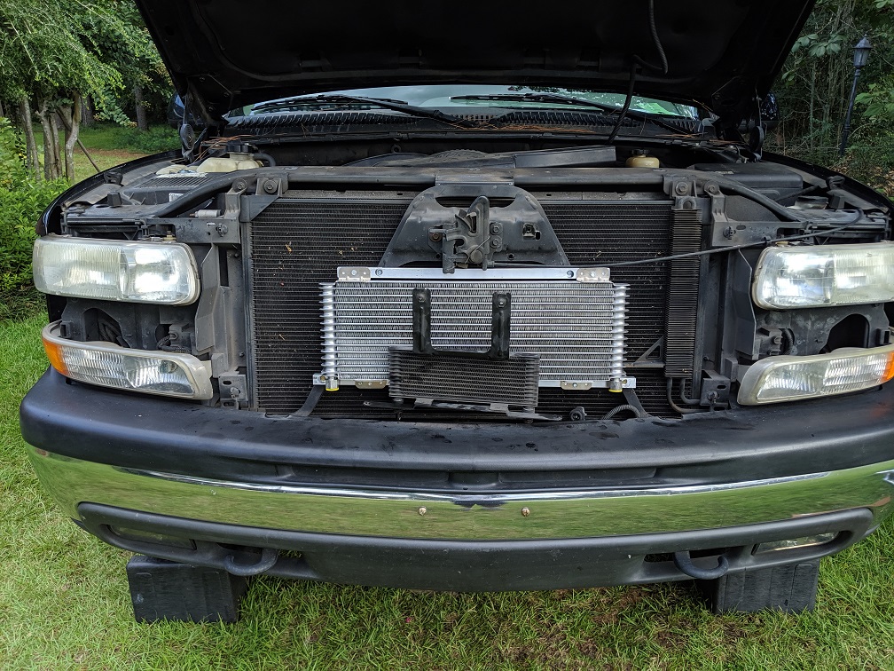

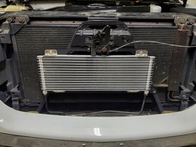

Some info on the cooler to get and how to install it:
Download this link
www.eadperformance.com/trans%20cooler/Tru%20Cool%20Install%20Guide.doc
Read these:
Some premade mounts (but I'm sure you can drill a flat plate):
Link for the cooler:
Amazon product ASIN B0060NKA1U(but you can find it cheaper on ebay sometimes)
This cooler works amazing.
So good that's what I'm using on my buggy too.

Really an easy install with that guy's kit. Pretty shady though. Just paypal some cash to random guy and hope parts come in. My brackets got dropped off a truck and run over at some point in transit, took about 3 weeks and a post office inquiry to find them.

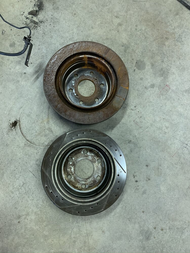

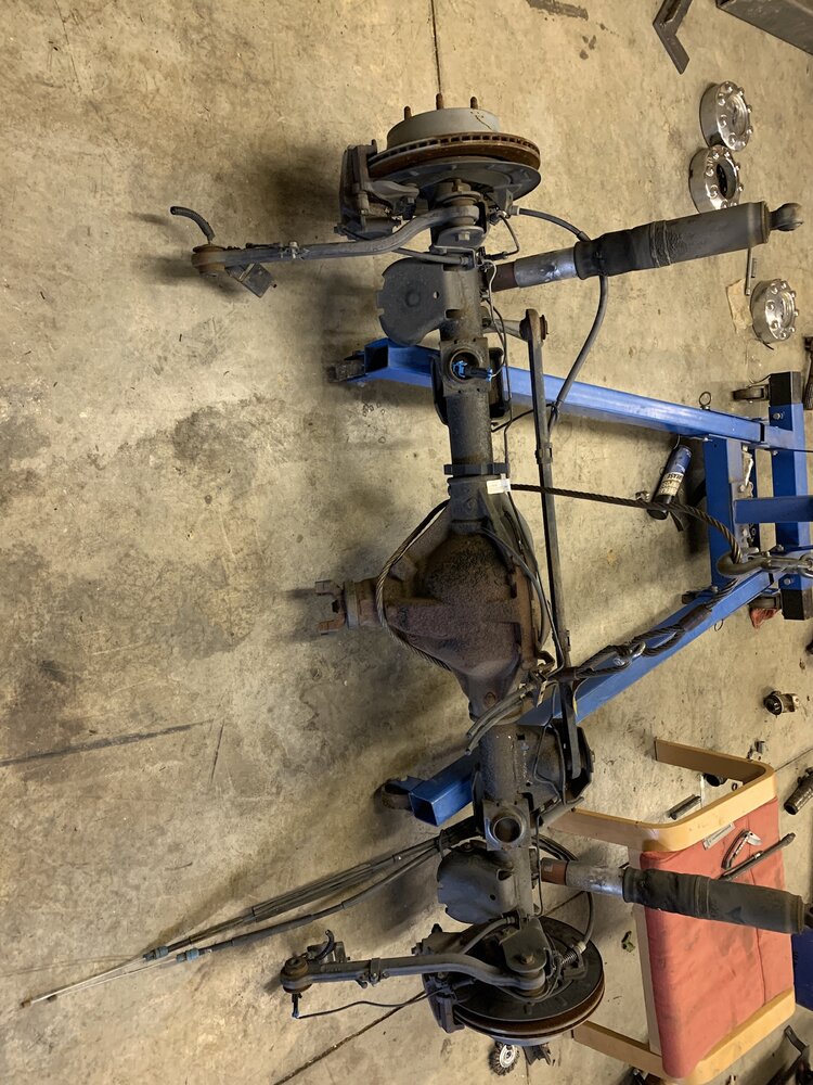

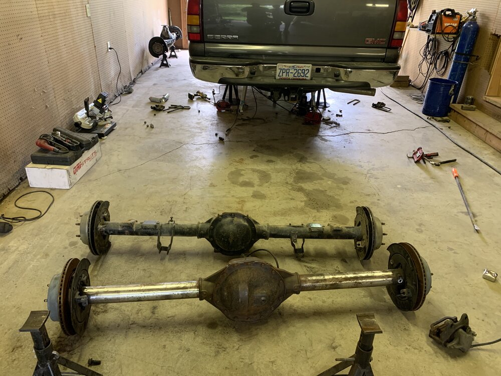

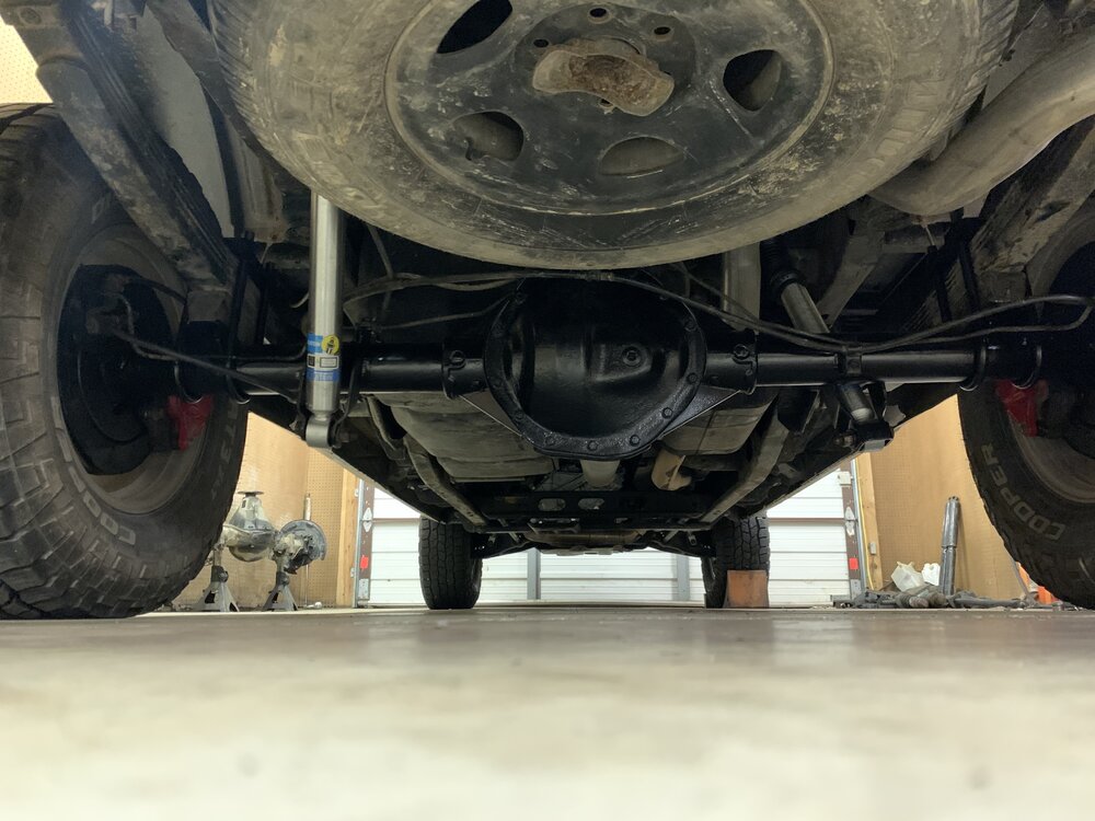

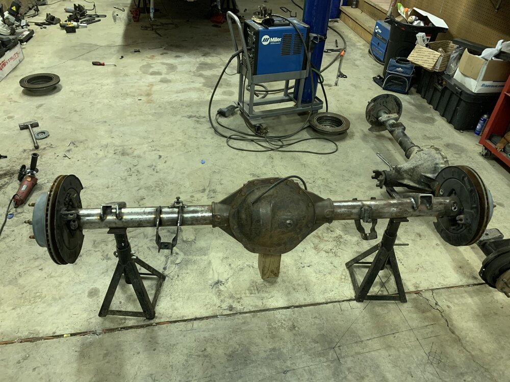

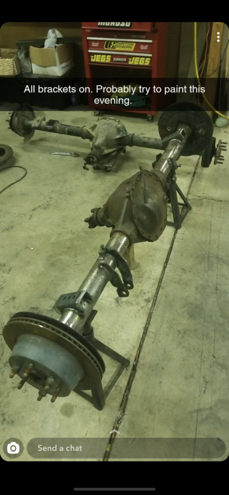

There are also 99+ 1500HD and 2500LD trucks that have 9.5 SF 14 bolts. Nab one of those and slap on some 1.5" thick 8x6.5 to 6x5.5 adapters. Boom. Done. Retain the rear discs and parking brake with another bolt-in axle option courtesy of GM keeping everything the same spring spacing :D
Or just rebuild the 10 bolt (AAM 8.6) as mentioned. They're not terrible.
We swapped one of the disc braked GM9.5 SF 14 bolts into a 1500 for a guy. Was a bitch to cut everything off but otherwise the swap went great.
Re-used his calipers, but the discs were slightly larger.
Had to change the u joint out for a conversion joint. 1330 to 1350 iirc
Spicer 5-648X U-Joint Kit
Driveshaft length was fine. Just different joints.
E brake and everything swapped over. We re-used all factory brackets except leaf perches.
That would have been a bolt in deal if whoever had sourced a truck axle!
