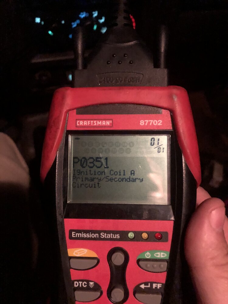

99 xj 4.0 runs like absolute sh*t. Was throwing crank and cam Correlation codes and now is throwing a p0351 coil a primary/secondary circuit code. I have changed both crank and cam sensor’s. Coil pack. Wire’s cap and rotor button. Swapped the ecm. And still having the same issue of misfires and want take fuel. Fuel pressure is fine. I’m at my wits end with this thing. Engine has 25k miles and was a daily driver weekend trail rig until a year ago when it stalled out on the way to go huntin. Got it runnin again and ran great. Then went to runnin bad Intermittently a few days later. Got irritated and let it sit for a year. Now it idles rough and can’t seem to get it figured out. Any insight would be appreciated.

Has a p1391 intermittent loss of cmp or ckp and a p0138 02 circuit high voltage b1s2 pending codes
