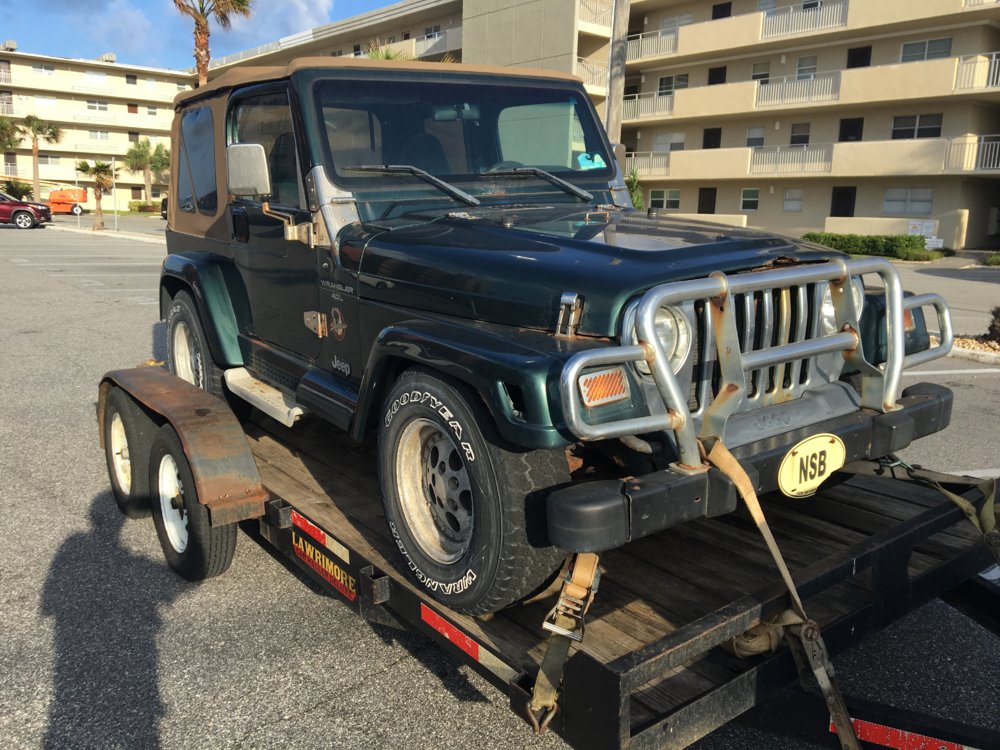

So looks like I'm going to get a TJ while I'm in Florida. 99 5 speed 150K miles. Rust on hood and body. Will have eyes on it weekend of 9/28. IDK what I'm going to do with a TJ but we will see.

I'll have eyes on it next weekend. I have nto seen this jeep in years. I do remember when she bought it though. Ideally I'd like to fix it for some street fun and forest road cruising. But it all depends on what it will need. I fear since it was in Florida it's whole life the tub might be rusty too..... I hate rust.

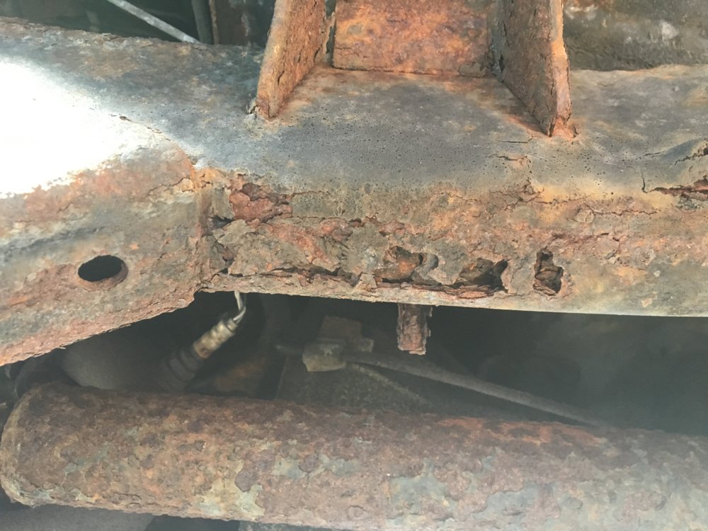

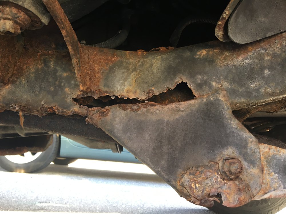

My little bit of poking says yes. It will need a frame, brake master cylinder and booster, and a hood. The windshield frame has rust on bottom the doors have rust on bottom too.
It's fixable. I'd frame swap it, if time is of minimal cost. If the tub is solid, it should only take about 20-30 hours if you don't involve beverages and have a (fork)lift. That includes changing all the frame hard lines while the tub is removed.. though if you get a good deal on a frame with the lines disconnected instead of cut, you'll be that time ahead. I'll give you $20 for it lol.

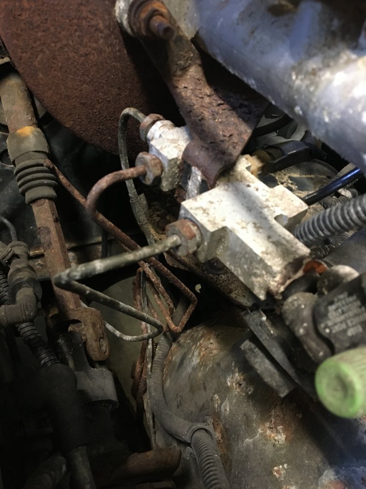

THe other TJ was sold before I could go look. MIL house has put all my projects on the back burner. However I was looking at replacing the Master cylinder, the reason for no brakes I was told, and found the passenger front line completely rusted out. I only see holes through the passenger frame so far. Was thinking about this kit:

Yes she’s crusty. Still was free to me. I noticed that line goes around the front. @Jeff B do these lines go on without removing a lot of body panels?
I had to take the drivers side fender off, was just easier. the passenger I was able to squirrel it in between the bottom of the grill and the passenger fender. I still have all the lines and the one I repaired. (put a short rubber line where it rubbed through)
