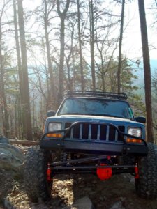

Wheeled it pretty much like that for awhile then decide to go bigger...Dana 44 and Ford 9in and 36in Iroks...
Rear axle upside down
And 5.13 gears and locker for front spool in rear...

Then redid bumper for winch and sliders...
Then built beadlocks...

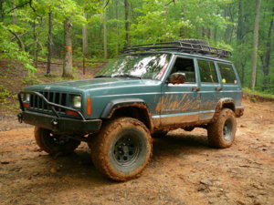

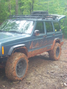

Here how it sits now...
Next is cage of some type, exo or inside undecided..
coils are rough country 6.5 lift. the leafs are out of an s10 ZR2 Blazer with 2inch rough country shackle lift..next I'm either going to buy HD offroad shackle relocation brackets or build some for better flex and shackle angle.

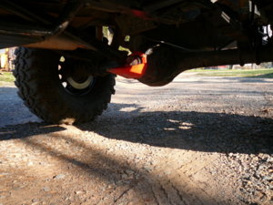

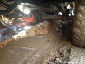

Got some pics of the underside today...

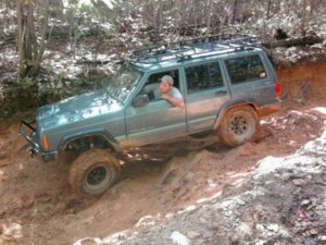

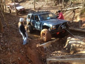

Here are some wheelin pic, not many since I got it back together. I attached a few more, last to are from the Flats got hung on the cement blocks had to winch.
