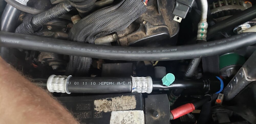

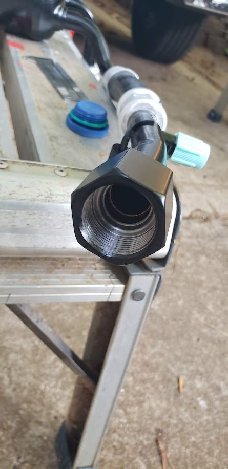

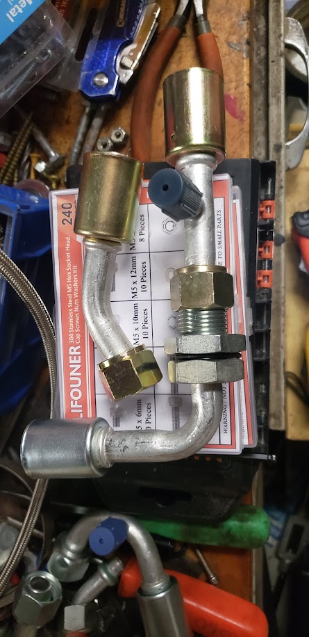

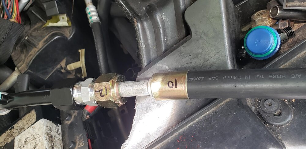

Pump End is a standard #10? end, coming off the pump.
I already crimp the end for the 'other' side (inlet) of the pump.

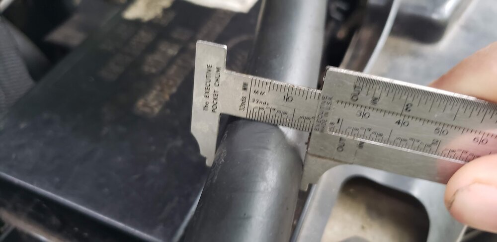

I am unable to find any information on the Ford accumulator end.
[I think its a #12 but I don't know exactly.]

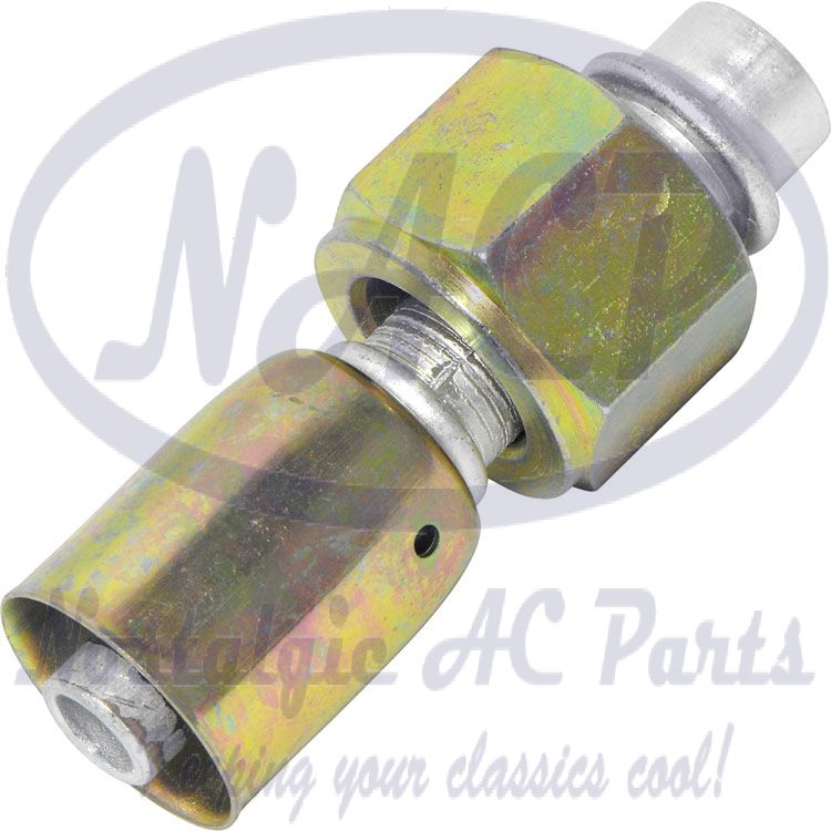

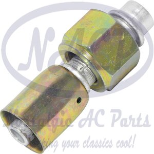

Also here a pic show the 'FEMALE #12 to #10 but i need a MALE
I can cut the #12 end off if need be.
I also have a fitting w/ #10 Straight female w/ charge port
I feel like im running in circles :)

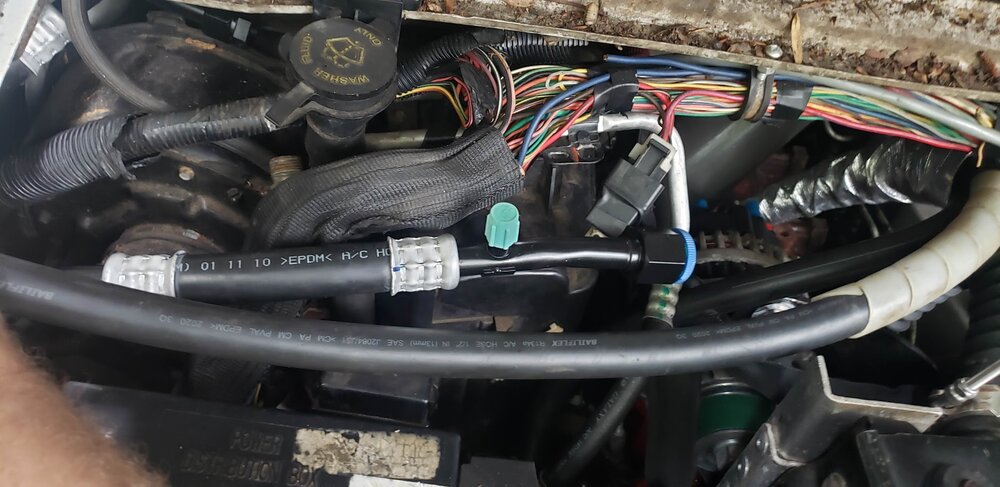

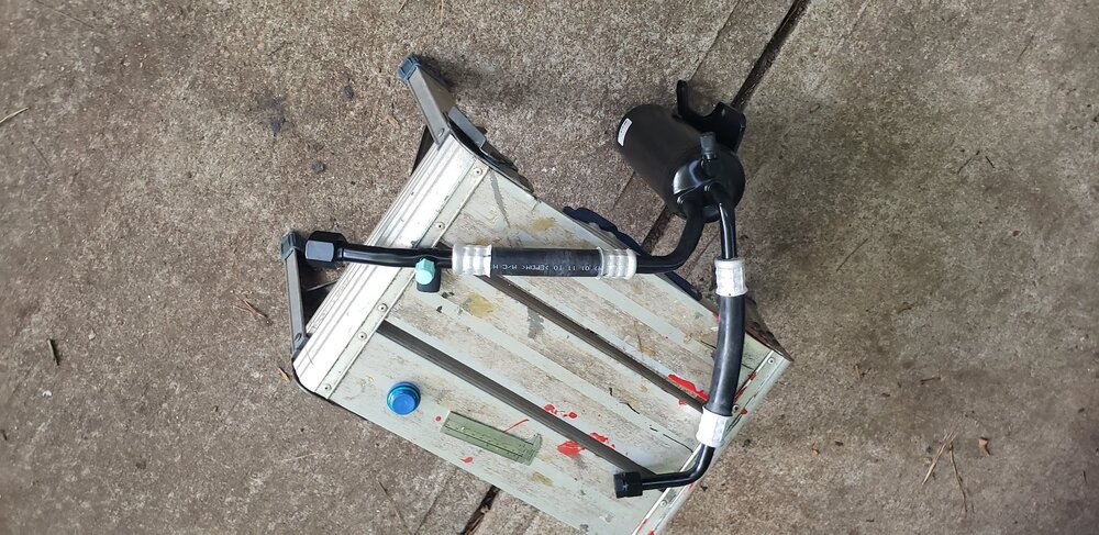

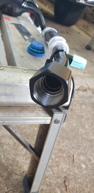

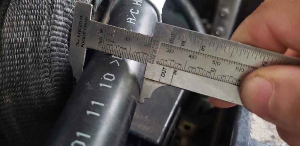

Here some pics of the end in question.....
Idealy Ii would find the mysterious fitting the is #12 MALE to #10 hose (the opposite of the one picture )
Where / Who has the ends of the hose ?
Different name I'm not use ?

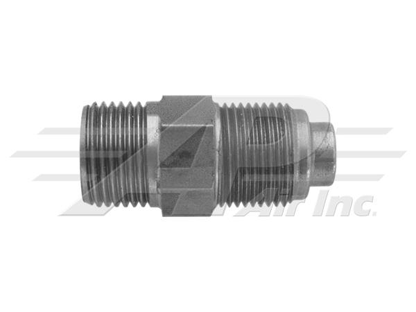

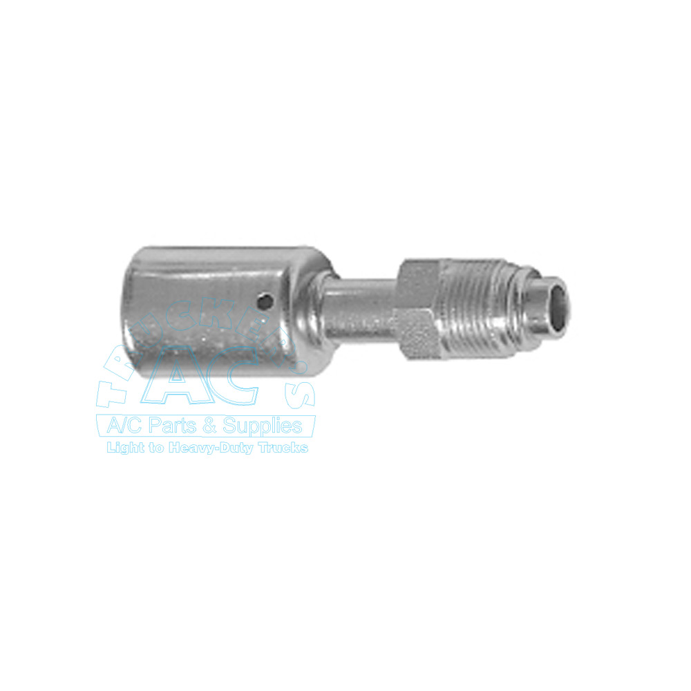

ya, I'm kidding.......:flipoff2:
This get me to where I can use this adapter, and a standard off the shelf, #10 --> #12 fitting,
while keeping the OEM r134 on the AC [accumulator] part.
