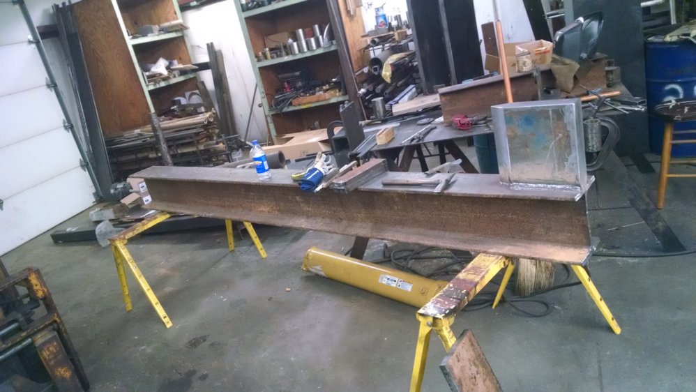

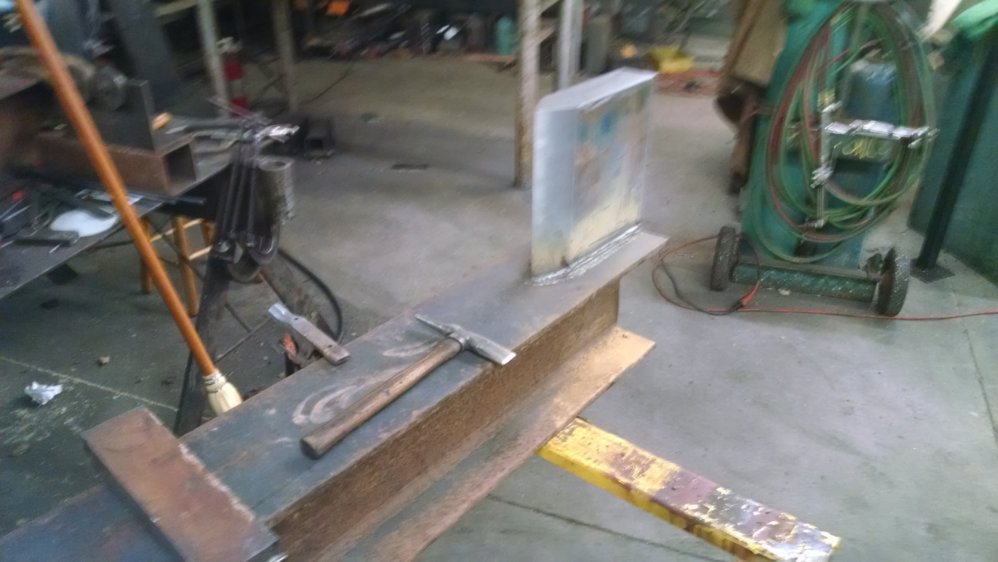

Quick run down. I got a phone call from a guy with a small weld job for me to look at I stopped by to look at it and it turned out to be a massive undertaking. He wants a wood splitter that will hook on a trackhoe and a skid steer. After looking at his steel pile and scratching my a.... Head I took the job. Day one taking a 1 foot by 1 foot block of steel 3" thick on a mill for the wedge. Cut the 8" I beam to length gluing them together with about 10 pounds of rods

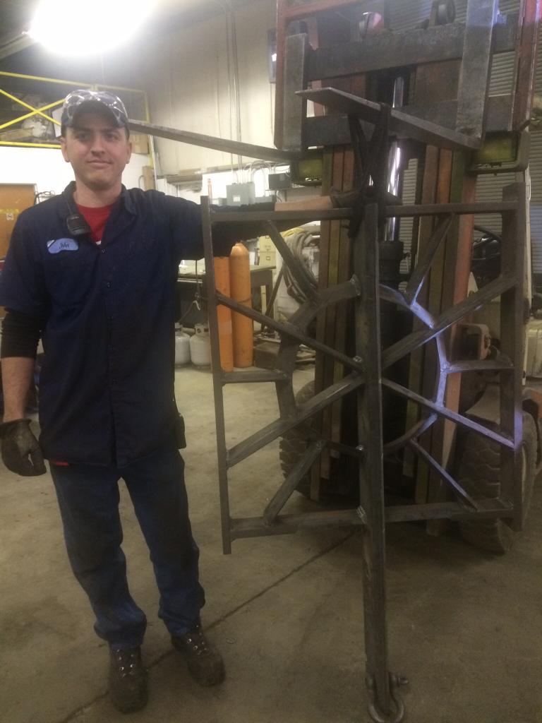

Here's a log splitter we're building at work. I'm 6'3" to give you a size reference on the size of the splitting wedge. Using a cylinder with a 4" shaft and 40" stroke to push the logs. It's also going to cut the logs to length before dumping them into the splitter.

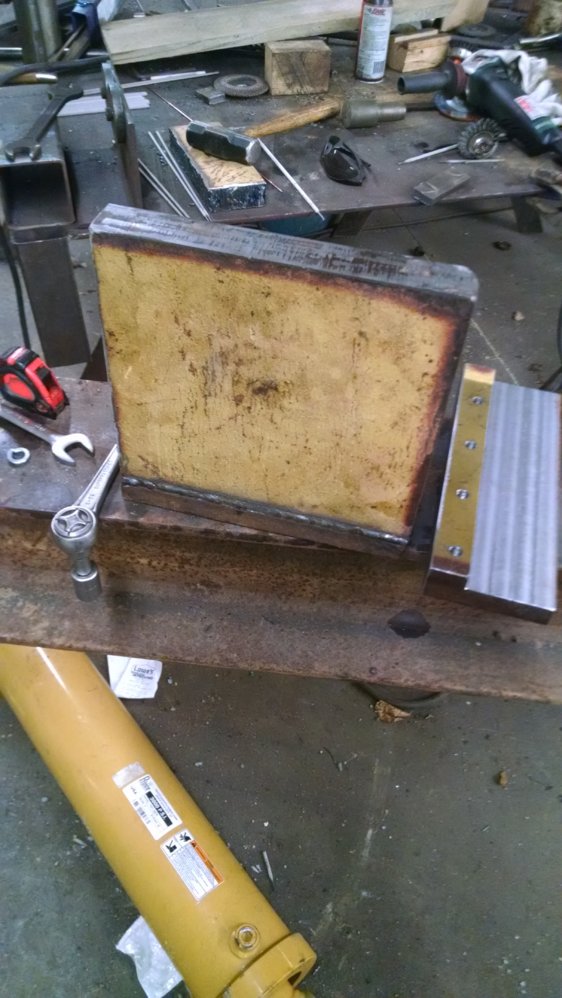

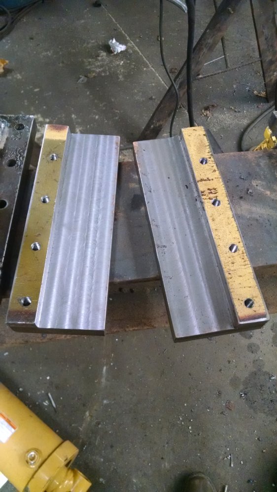

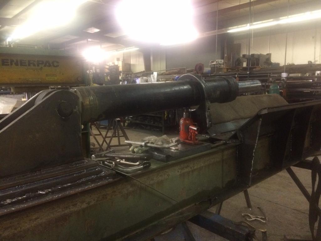

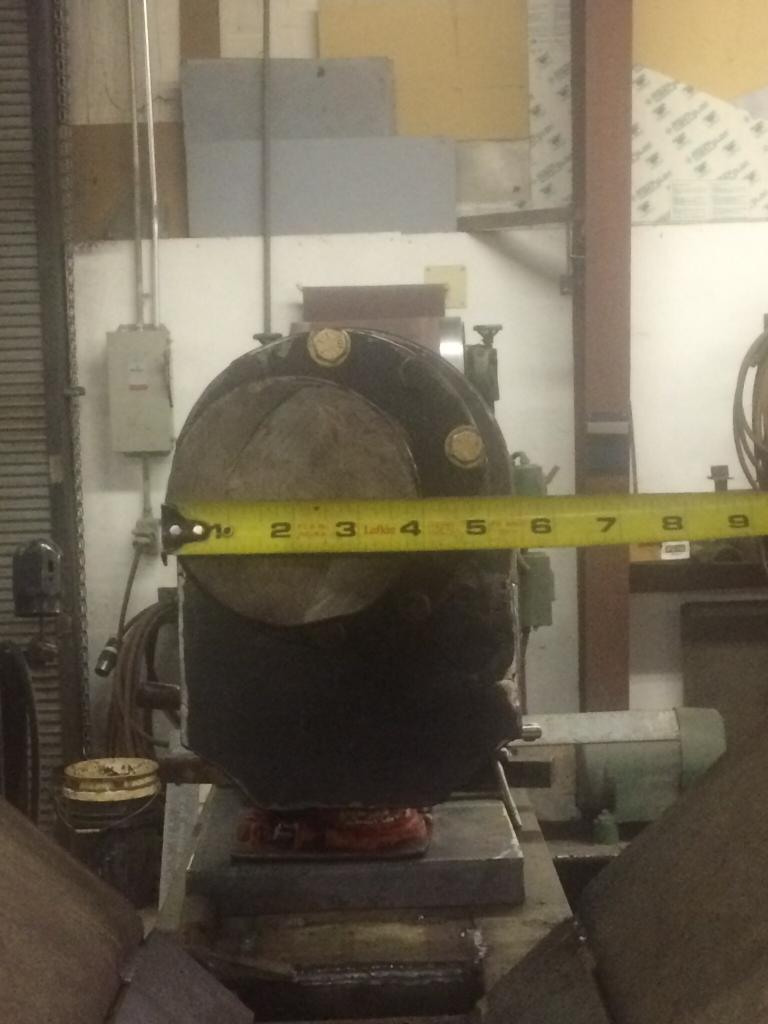

Not getting to work on this as much as I want but here is the pusher block and wear guide's finished

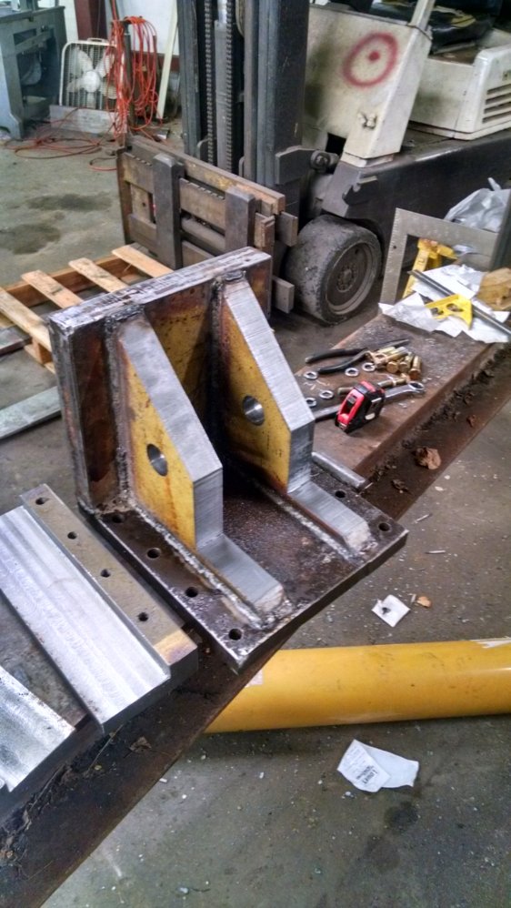

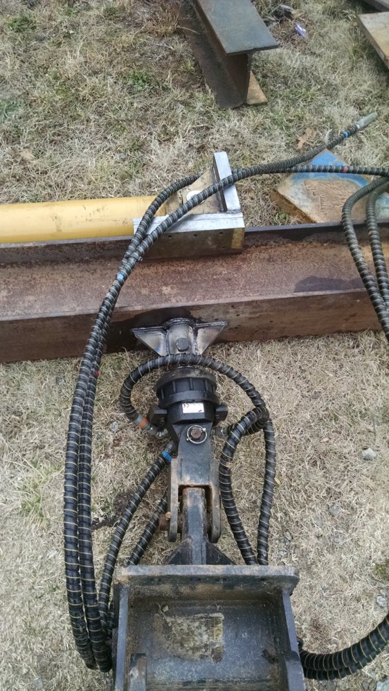

Cylinder mount done on to the attachment for the trackhoe and skid steer

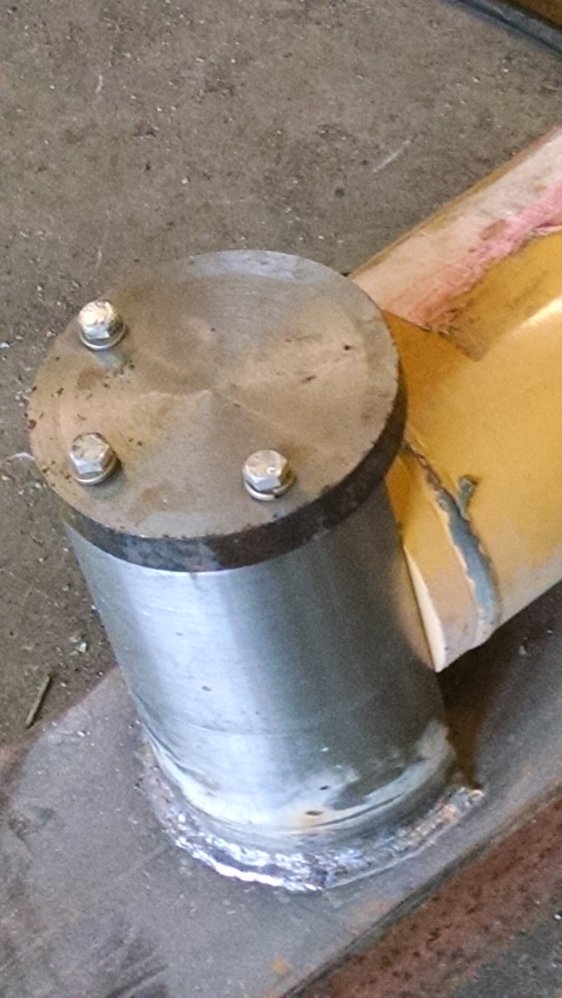

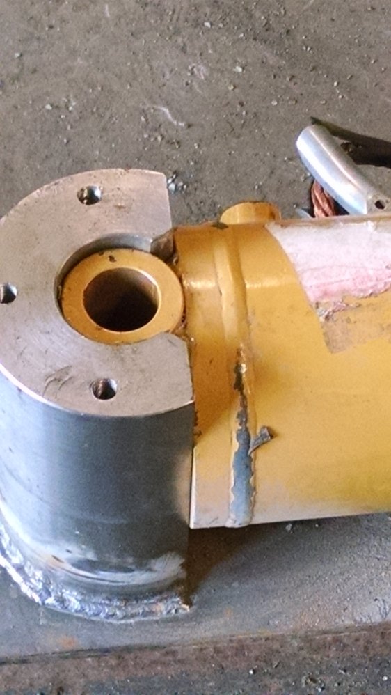

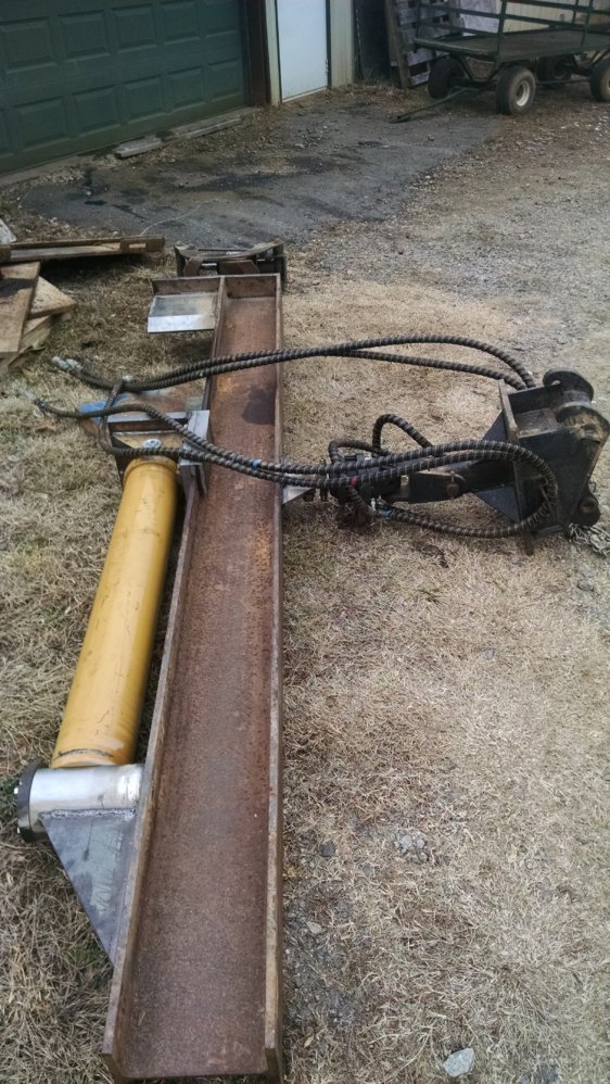

Finished the last pic is the best one customer was happy enough to give me a bonus on top of the total price and he played in cash :)

After the other dude posted the processor pick I got confused until I looked over the thread in its entirety! @loose cannon , seems that whole bit was out of salvaged material or customer supplied components or both. I like the use of the on hand stuff. Builds like this express creativity and dealing with what you got. Nice to see a man get paid for his efforts too. BTW interesting method of arresting the cylinder on the non functioning side. Your probably going to have to add some wedges to that knife at the back, looks like the flat bar is about 2 inches or so out from each side with no slope, that square edge is going to hang stuff pretty bad. Can't be sure by the pic. If the owners conscious of the capabilities of that cylinder and your work is solid it should serve its purpose for a long time.
I did think about and cut 2 pieces of flat bar to go in the corner's but I took two 2/4 and ran them down the wedge it cleared by 6" or better I can still put them in later if it causes a problem. And yes the customer supplied all the metal I just did the work thanks for the complement I am a fan of yours on the killer welds thread
