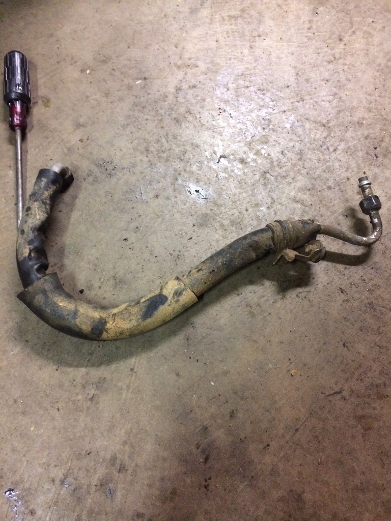

So Im looking to repair the AC system on my Toyota Pickup. It was working perfectly fine until I got a pinhole in my AC High side/discharge line. I can't for the life of me find a replacement for the line. I called up NAPA, Oreillys etc and they only have the suction line. If anyone knows where I can find a replacement or have one custom made let me know thanks,
BTW Truck in question is a 1984 Toyota with a 22R.

can i have the VIN number please ? and possibly a pic of the line ?
i might be able to come up with a part number
Most Hydraulic shops can make custom A/C hoses as well. Only hiccup could be if there is a manifold/block assembly or proprietary fitting in the line that they can't reuse.

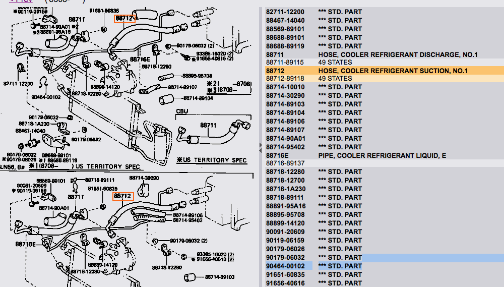

88712 hose comes up as obsolete just running PN thru GOOGLE

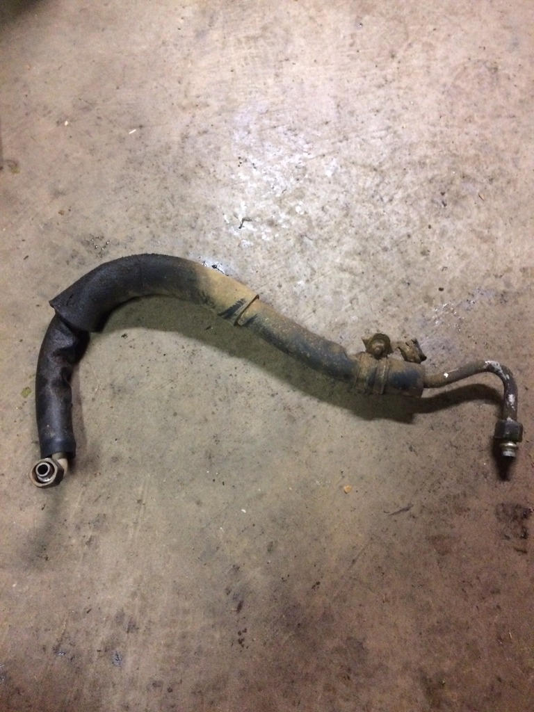

the other hose 88711 is available fairly cheap from a few sources ( you hose looks like this to me from your pix)
More Information for FOUR SEASONS 55980 if this is the correct hose its $20 on Rockauto
Thanks for looking that up. I bought the 88711 hose before but it was the wrong hose and wouldnt fit. Rock auto also lists it as the suction hose and not the discharge. I did look on rock auto and tried an 85 year model search instead of 84. I came up with this hose:
More Information for FOUR SEASONS 55981
This one appears to be the correct hose despite it being listed only for 85-87. I might see if Oreillys can get me that hose and if it doesnt fit ill return it.
