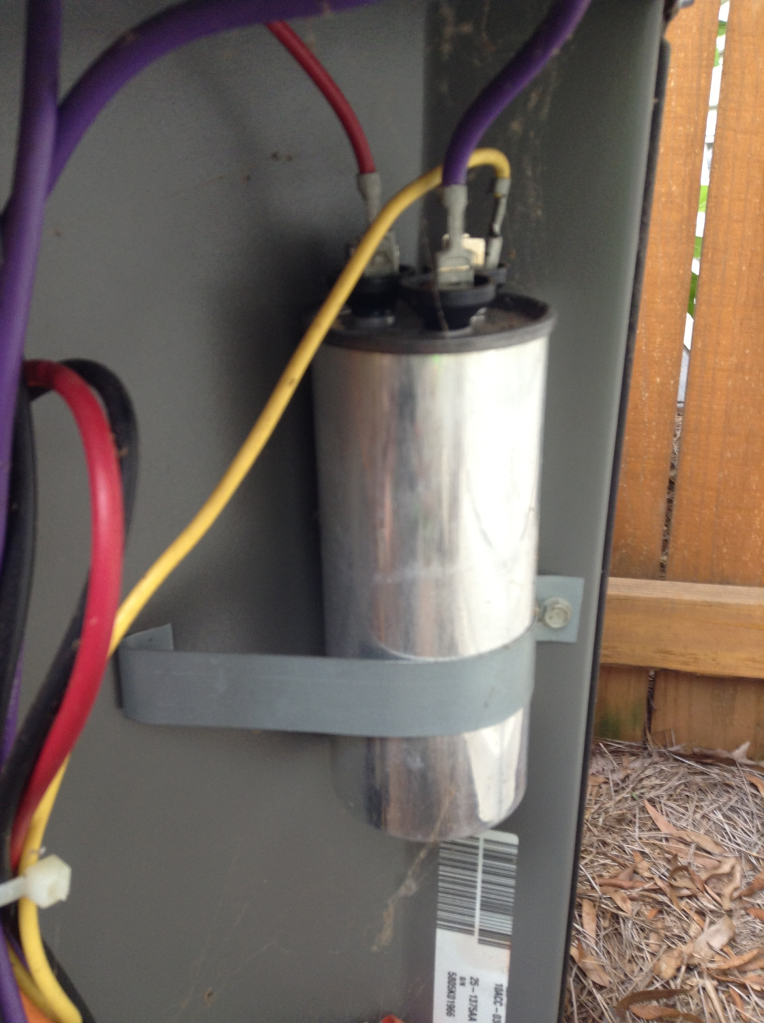

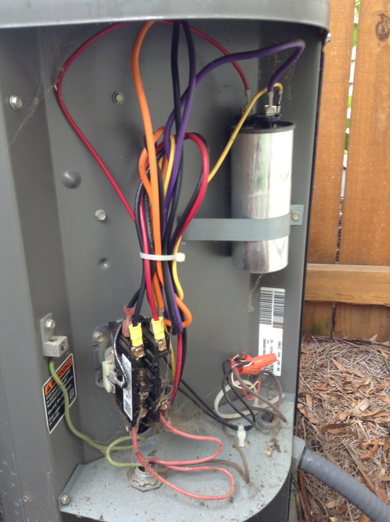

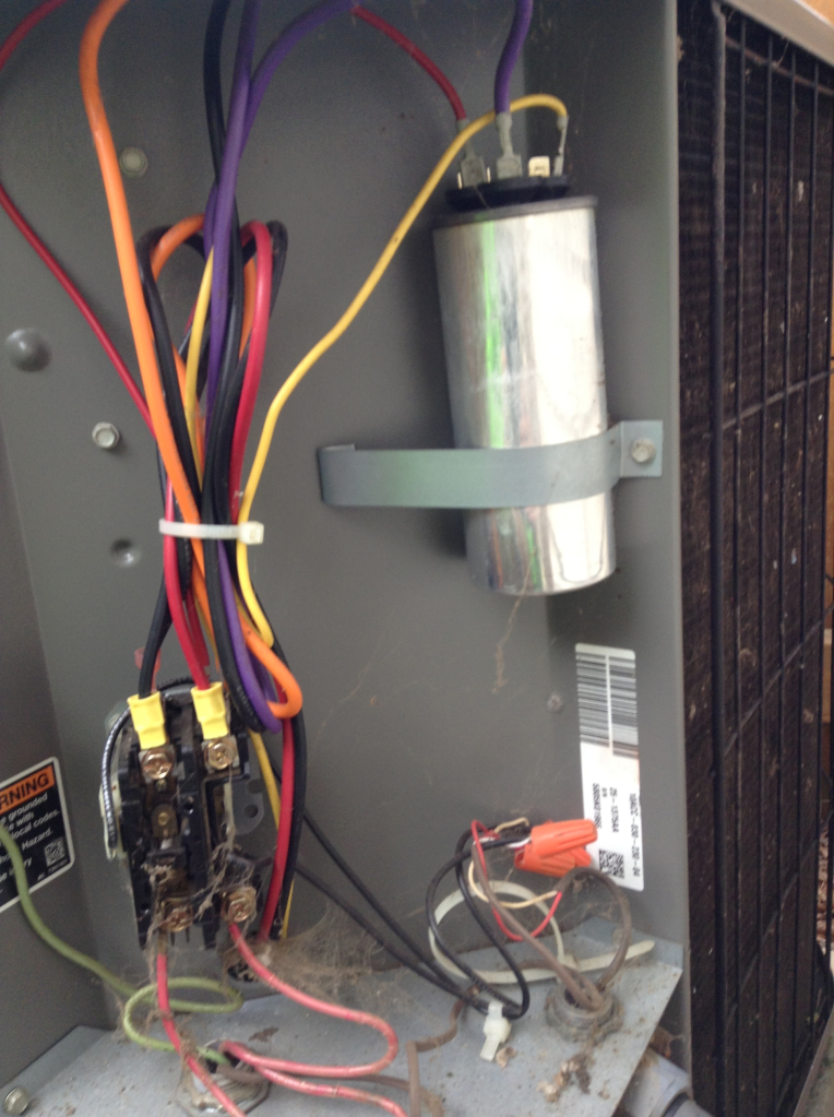

Can't see the bottom of the capacitor in the pics. Is it bulged out?
We've also had bugs get into some switch, short circuiting it. Maybes its that thing to the lower left of your capacitor.
