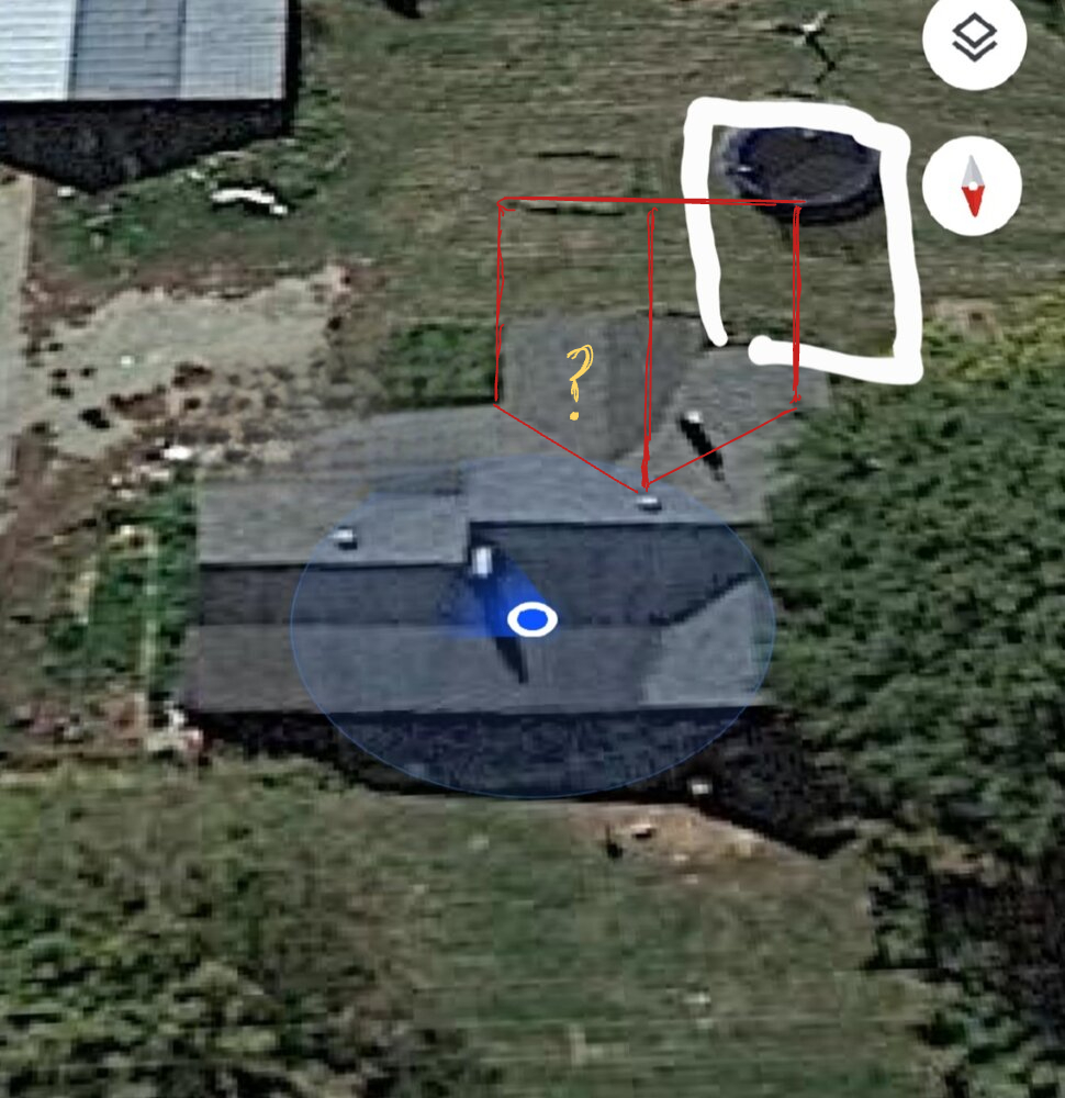

make sure your septic, leach field, lines, etc are not in the area of your proposed addition, I once looked at a house where they built a garage / in law suite on top of the septic tank.
Part of the line to the tank would have to be under it. But tank and field are on down the hill.

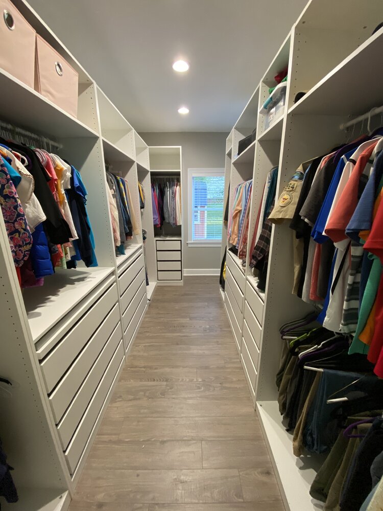

A nice closet will change your life! You should add one while you’re at it. I built this one in our master bedroom last year. It’s one of the best changes I made to our house.
What I see is an opportunity to collect a lot more stuff than you need :D

Your first step is to find out what your septic capacity is. If you don't know the county should have it on file. They'll also (theoretically) have a schematic of where it and the drain field lines are. That will tell you if you have an expense to plan in that arena or not.
My house as made in 67, I learned the county has an extra record from the early 80s where the tank was replaced for some reason with a larger capacity one and they ran a new line out to it. No idea why, there's no additions here. Guessing they had some kind of failure and figured miight as well replace with bigger while doing the digging.
Good info so far. I had the septic data at on point, but can't seem to locate it now.

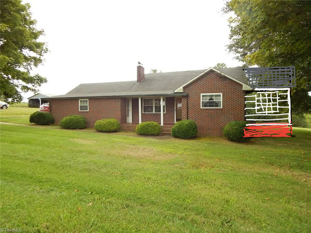

Without knowing how your house is laid out currently and dimensions makes it a little tough to figure out what's a good solution for adding on a master bedroom and Bath. Where you have it proposed right now, I wouldn't recommend it. From an aesthetics stand point, i feel like its gonna throw the whole thing off, and it would be a booger to tie that roof. If it were mine, this is how I would think about adding rooms on, but your interior layout is what's gonna determine which is best.
Where are you stairs to the basement? if possible, I would almost be inclined to build around those so they are accessed from the interior....
Looks like it’s been added on to multiple times. Wonder if it wouldn’t be best to restart with a whole new truss system and extend something out. Already looks like a roofing nightmare.
The first option you show would be going right through the bathroom.
Second option is kind of what I have in mind, and would be bringing the basement steps inside.
