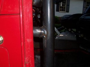

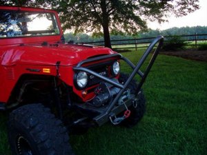

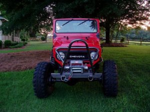

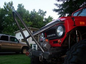

Added a little tube to the front end and was wondering what yall thought. The 2 bars that go to the stinger are tied into the cage and go through the firewall. Got to give a little credit to a buddy that had does his dad cruiser somewhat like this for the main idea but we took it a made it atleast a little different. :D

front...

Were it attaches to the cage inside...

last....

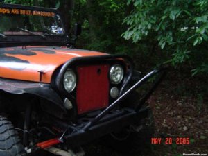

looks good, i added a radiator hoop and stinger to my cj and was looking for ideas on how to tie it all together. i like the lines of yours.

rockcity said:
that stinget won't do much good without support to the hoop...
but i'm sure you already know that
are you sure?
because i think thats why i said i was looking for ideas as to how to run the tubing tying them together... :flipoff2:
Wolfpack OffRoad said:
Looks like a tree fell on it. Or somebody hit it with a pole.
He rolled it.

Yea, the dent was were I rolled it and the tree caught me on the passenger side from going down the mountain. I wish I could scan the pics I have of it but it was basically passenger side tire picked up and I couldnt back out of it in time...the pass. side came over and caught me on my roof. I had a total of 30 miles on her and it was the first trail. :D I guess I had to get it over with right? Rolled it back over and wheeled the rest of the day.
