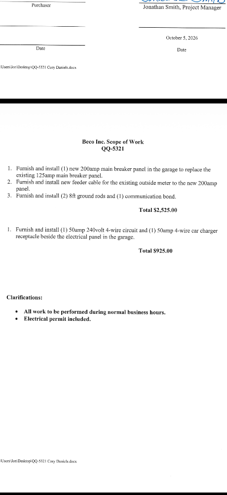

To be honest for a business - especially one the size of Beco - to do this and permit it - that’s a very fair price.

OP: Thanks, I got a quote for a 14-50 plug.
This is the quote. Obviously, I want this done right, but also don’t want to pay an arm and a leg if I don’t have to. I don’t need a 240v as the 120v will do just fine for my needs, it would just be nice to have to faster option if I ever needed it. I am just nowhere near even remotely knowledgeable in electrical work.
That's a surprisingly reasonable price for a panel upgrade, especially if this is a decent sized company like Rod says.
That being said, unless you're replacing a fed Pacific or zinsco panel--you almost certainly don't need it.

The problem with the 1450R is the sleeve depth from the face. If an owner isnt careful to fully plug in or allows something to hit or pull the plug out even the slightest, under heavy charging you create a thermal event.
There are reddit communities full of melted chargers, cords, and burned walls.
The tesla wall connector just eliminates all that. It also means OP has to now buy a charger in addition to the fee he is paying for the outlet install. Curious what charger he is planing on buying. This is one of those - dont cheap out on import junk it will bite you in ass.
I feel like I paid around $1500 some 15 years ago, went from 100 to 200 w/ the o.g. switched over to a sub as mentioned above.

If his super sized golf cart is a Tesla, he will want to buy the Tesla mobile 240/120 charger (~$250) or the fixed charger. I think the fixed one was like $400. I went with the mobile. I keep slack in the cable and have never had an unintended pullout.. take that however you would like....
