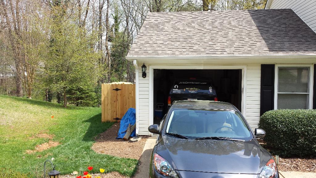

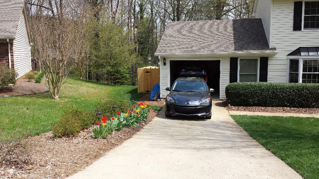

So as of now. I have a one car garage with a one car driveway. I would like to be able to extend it somehow so that we can have both cars parked and not have to move one or the other to get out. Below are some pics so you Guys can see what I'm working with. I am just looking for options....I'd like to have something covered, but don't really wanna mess with the existing garage...I'd even be happy with a little parking spot right beside the garage. I just want it to look good and not like I just threw in an extra space for parking.

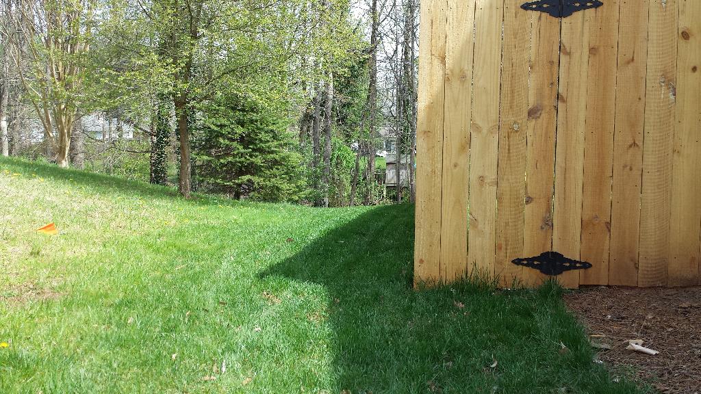

Orange flag is prop line.
Without seeing a picture of the whole front of the house, my knee-jerk reaction is to say widen it towards the house. Keep the driveway width at the street then curve it out towards the house then straight back just past that window to the right of the garage door. I am assuming your property line is fairly close to the house, and depending on the laws in your area you may need a variance to put a parking pad that close to or on the property line. Plus you will lose a lot of your landscaping. Adding to the right instead avoids all of that, and since the car will not be parked in front of the main part of the 2-story structure it will not look "wrong" since you are still parking in front of the garage.

Is that orange flag in the picture denoting a property line? I'd say you will probably not be able to extend closer to the neighboring home on the left, there is a reason everything is laid out the way it already is.
approx 5 foot from the flag to the fence ? thats probably the easement allowed by the city/county, which is why the fence isn't built ON the line, and that probably as far over as you can build a driveway without a variance.

And from my line to the fence is probably more like 7 feet. Our prop lines kinda look like a piece of pie.....gets larger towards the back of the house.

Personally, IF you have enough room on the side (given the above restrictions) I'd expand the driveway starting about 20' before the garage and add a pad beside the garage (so you have like a triangle and a square). One advantage to that is if you ever get a boat or a "project vehicle" that is a good place to put it, tucked beside the garage, so it is out of the way and direct sight - hides the "eyesore" from grumpy neighbors.

How far is the flag/property line from the outside wall of your garage?
Its about 7'

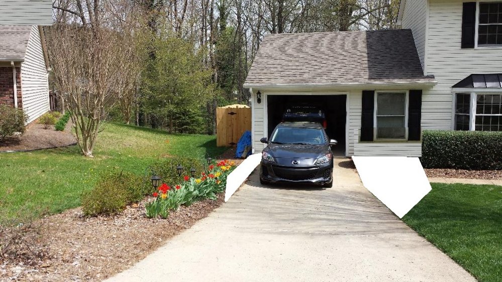

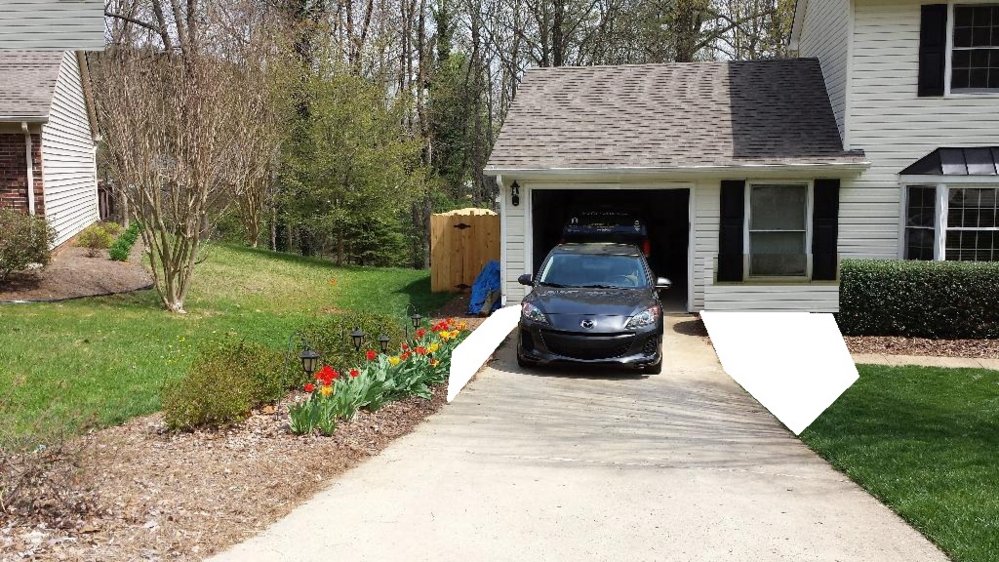

Typical driveway is 10-11 feet wide. 7 feet would be super tight. You would end up stepping out of the car onto your neighbors grass most likely. I think I would be tempted to widen the pad about 2' on the right side of the house, and about 8' on the other side (towards the front door of the house).
Something like this:
bringing the right side pad all the way to the curb will give you more parking option and a place to walk around with out having to dodge the car in the way. park close to the house and your front walk is obstructed, and a bigger paved area for other stuff isn't a bad idea either.
