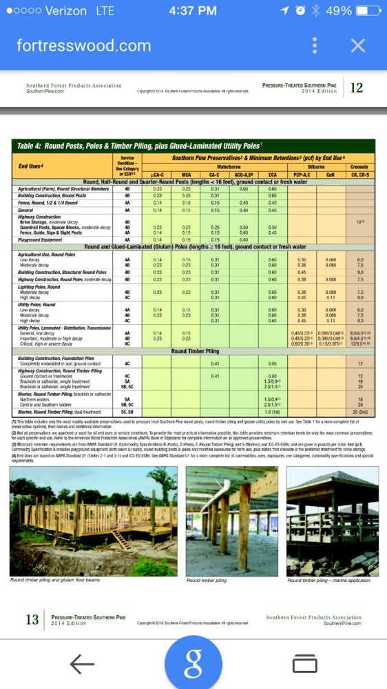

Get ahold of the AWPA U1 standard and look up the area for round building pilings.
