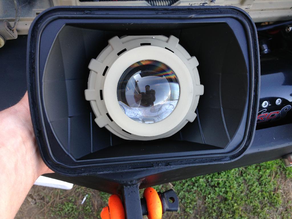

Hids in your halogen projectors will not have a good cutoff. Granted they will be better than hids in a halogen reflector housing. Please if you are going to do this, do not get 3 billion kelvin.
Of course you could do a proper retrofit and have great cutoff and light output. These are a set of Fx-r projectors I just got done doing for my XJ.
He's right. Go with 6k or maybe 8k. Anything higher than that is more color than light. 5-6k are bright, crystal light output.
