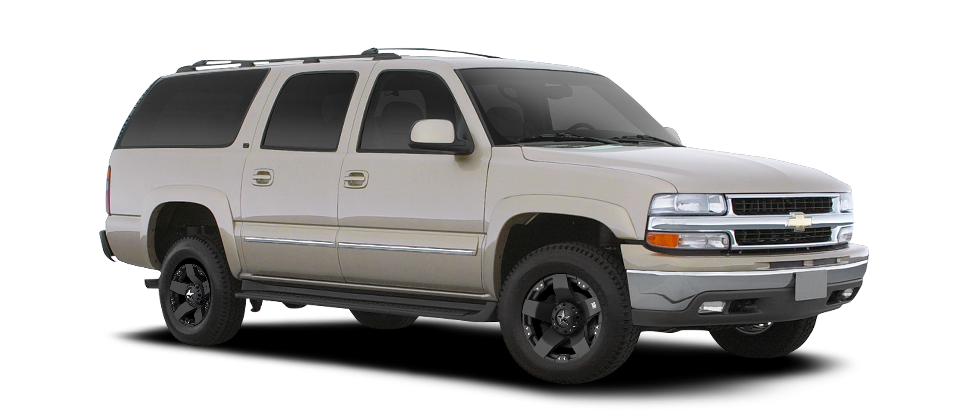

i think mine is 4.10 gear running stock 245 running 75 mph on hwyway it is turning 2500 rpm but it had the factory 16" rims and i am going to 17" with 265s. and these are the rims am going with they are 17x8 size
