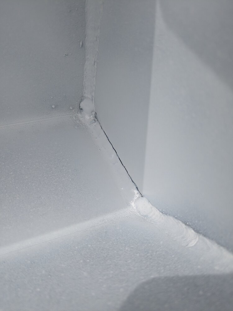

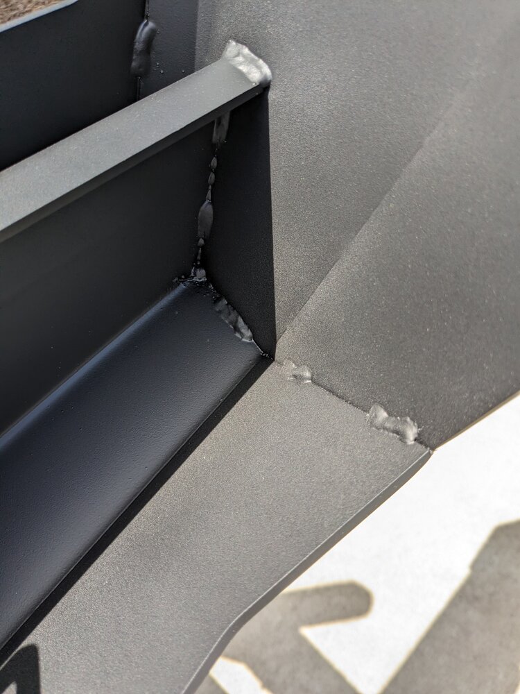

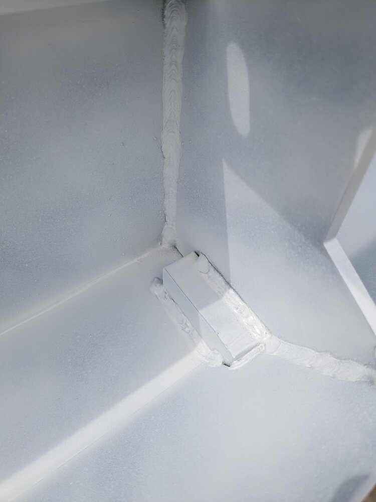

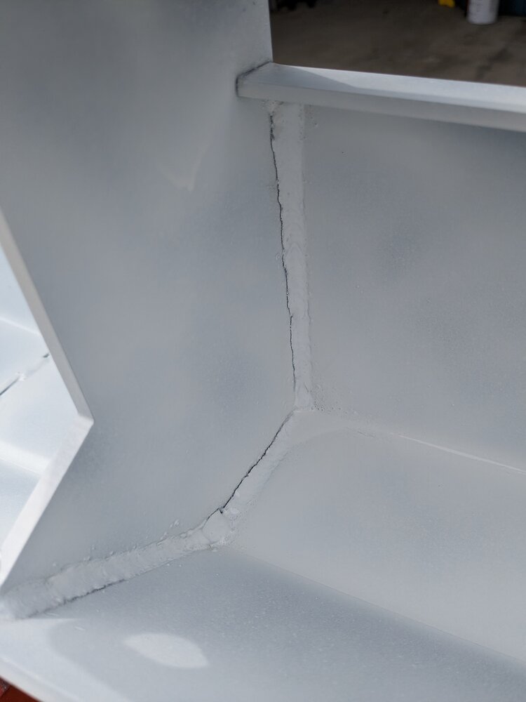

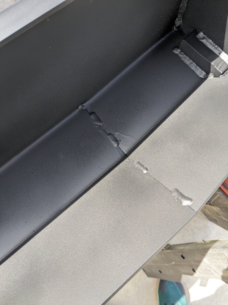

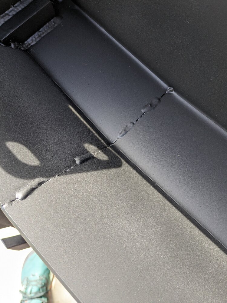

Bought a new rear bumper for my XJ from a reputable vendor/fab shop. Primed it with white clean metal primer and some weld issues became glaringly obvious. Cracks in pics are where the bumper 'body' connects to the horizontal mounts which would bolt to the Jeep. Also, most of the bends only have small stitch welds at the joints. I'm not a welder but would appreciate feedback from those of you who are. I've got concerns about the structural integrity and question using the d-ring tabs.
