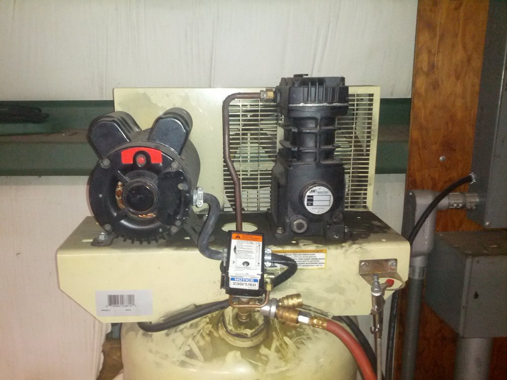

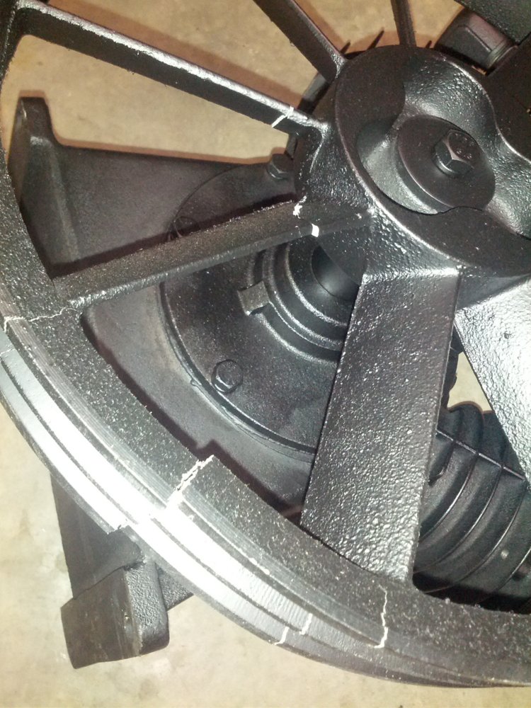

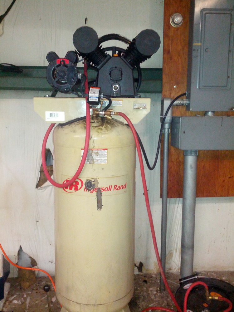

Those of you that see an air compressor out of the corner of your eye, may know that we run a 60 gallon IR SS4L5. I'm not sure how many hours this machine has turned in it's lifetime. The head gasket busted earlier this year. I made a new one that is still working fine, eh 4-5 months later maybe.
The pump isn't building pressure now. I don't think the new head gasket has anything to do with the problem, but the material I used was a hair thicker than the previous material?
So, no doubt the valve plate on top of the head is worn out. The part is $135 not including shipping.
Eventually I will get a big daddy Quincy, throw away my electric tools and not have to mess with this again, but until then I need the cheapest solution for decent air, basically just to get me by.
My pump makes 14 cfm @ 90 psi @ 135 psi max w/ 5 hp

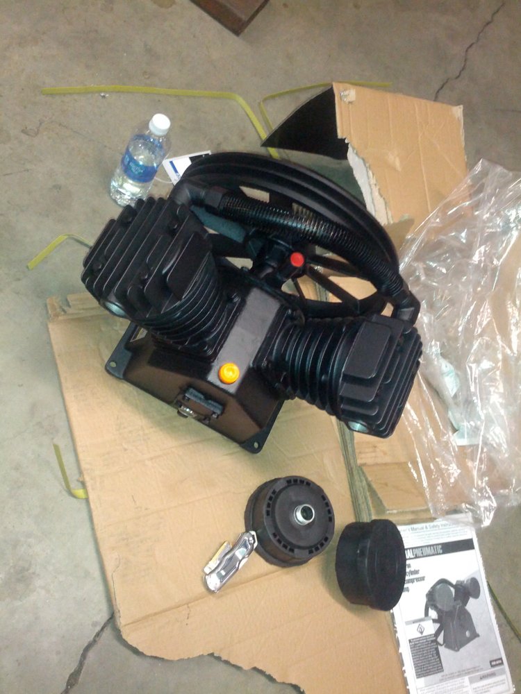

The 5 Hp V-twin from Harbor Freight is $180 - 15.2 cfm @ 90 psi @ 145 psi max w/ 5 hp
Assuming it the HF piece is the right thing for the job "right now"
Any suggestions?
