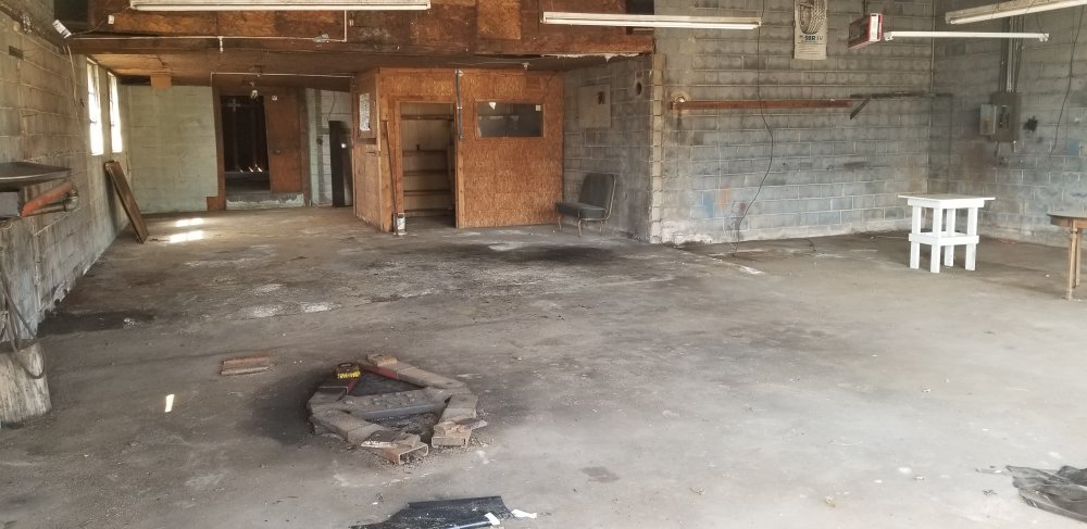

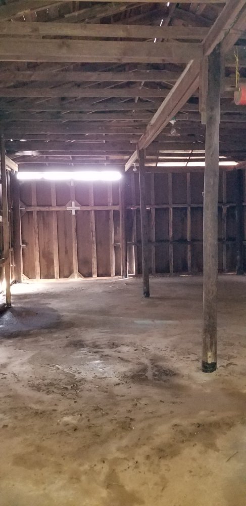

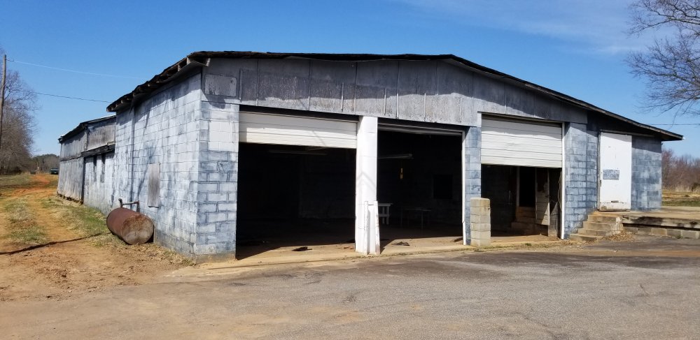

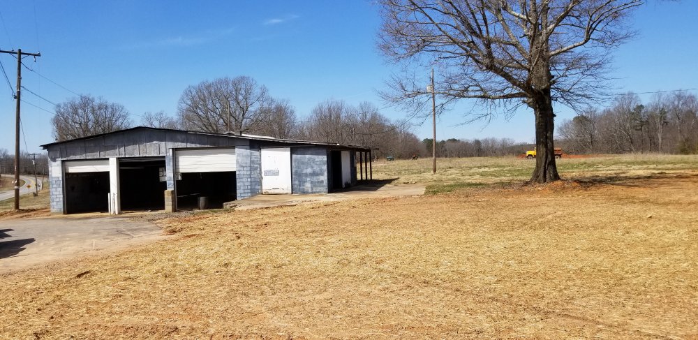

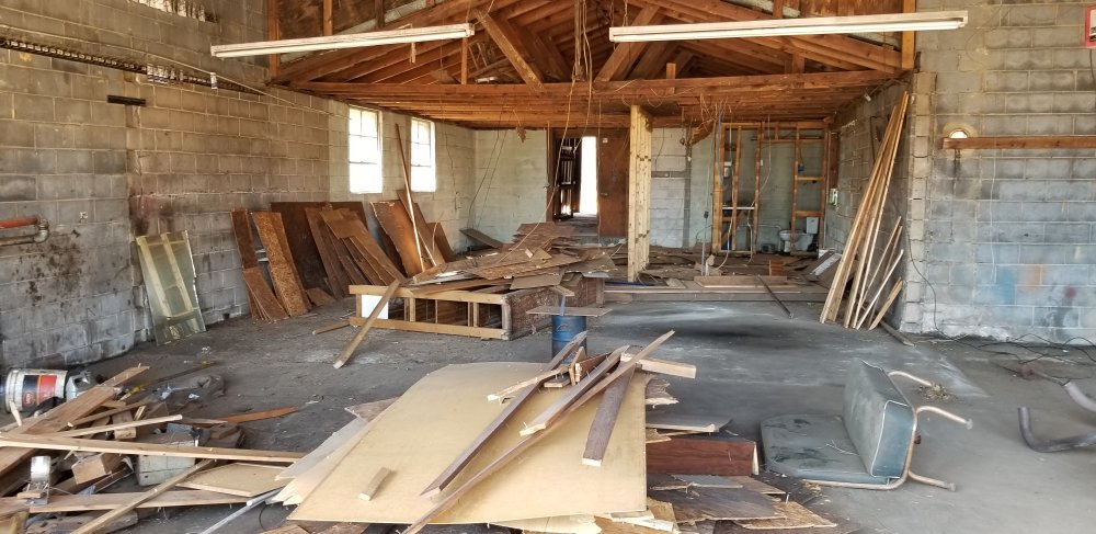

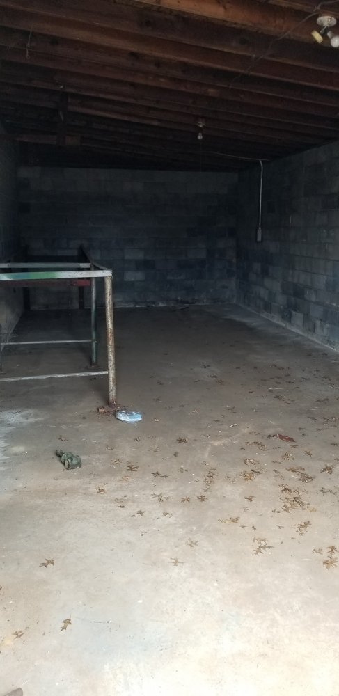

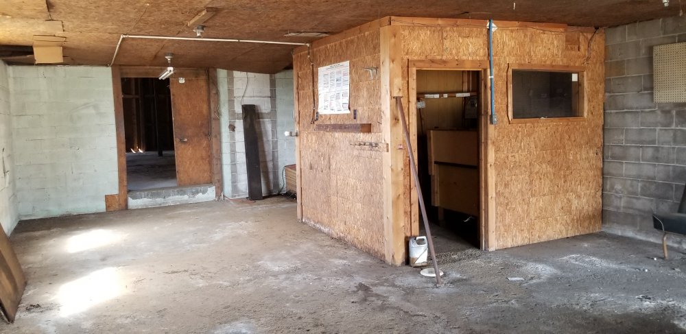

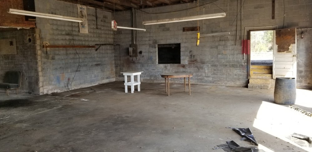

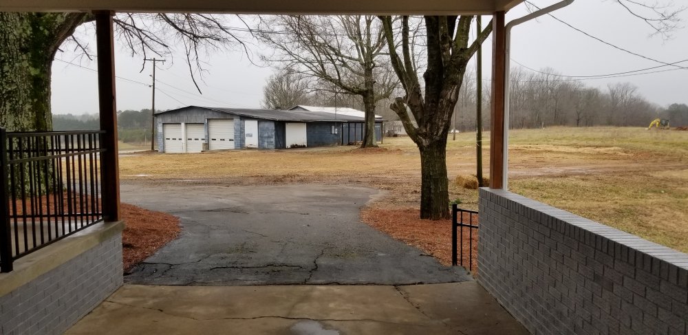

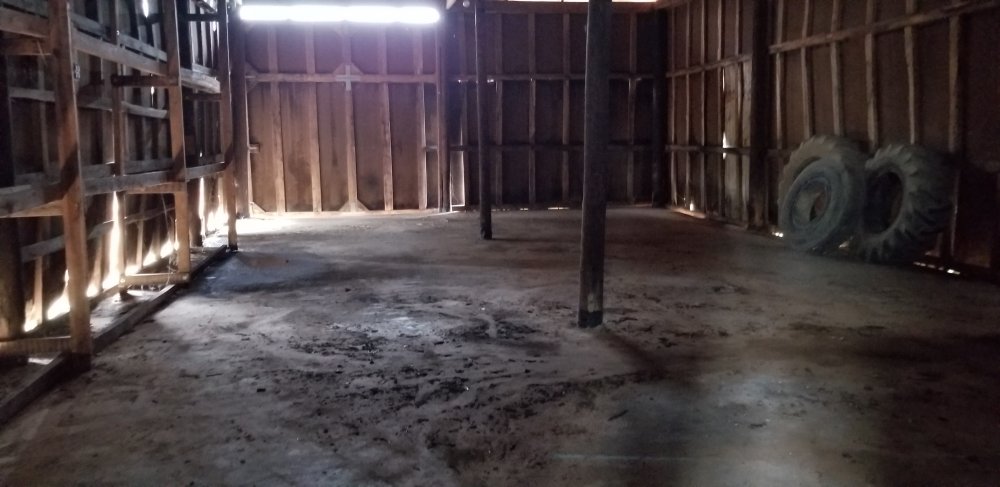

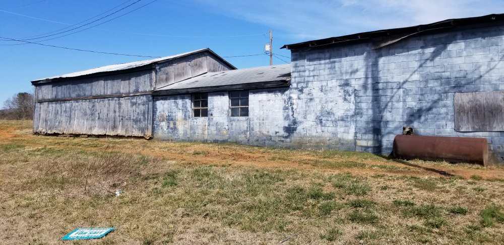

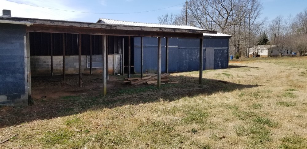

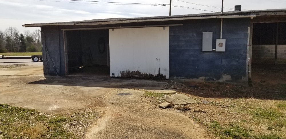

Got some pics of new business place.
I got a lot of work to get this shop ready but lots of hours, little sleep and itll get there lol. Here's the new shop!
Lots of space, pavement is gonna be sweet!! Not only work but looking forward to building my new rig on pavement for the first time ever!
Plans are front shop with bay doors for mechanic work (6 cars comfortably), rear shop 6 project bays for fab work. 1 bay off the front right for CNC plasma table where just enough room for forklift to load table through a 8ft door
Progress today
I'm happy for ya man. You're chasing your dreams.
I see a lot of very dry and old exposed wood there. You have a construction background, so I'm sure you'll look out for fire prevention measures. It may be worth a chat with the landlord to be blunt. For what you want to use it for, they may be obligated to do some work themselves to make the city/county happy.
Oh yeah we are getting things done, fixed modified to be safe and code compliant
