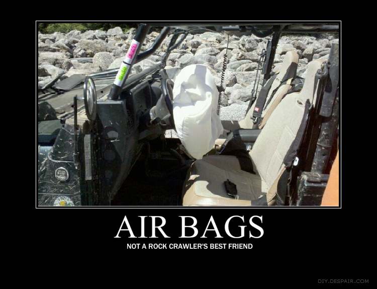

When mine blew when I was out crawling a few years back, I was worried about it. The steering wheel and dash were still split open and it was obvious they had gone off. Even went to a station that I normally never go to so I wasn't a regular customer and no questions were asked.
Yeah, but compared to the rest of your Jeep, that looked showroom... :p
Did it scare the hell out of you when it went off? What'd you do with the bags once they did go off? I've always worried about those things letting loose while wheeling.

Yes, it was like a shotgun going off in my face. I had my mouth open and everything! After they went off, I cut them out and kept wheeling. Don't ever let anyone tell you they wont go off in low range, or they wont go off under 20 mph, or they wont go off unless you need them to. None of those were true in my case. Modern airbags are all about g forces, enough force from any angle will set them off no matter your speed. (Sorry for hijacking the thread).
