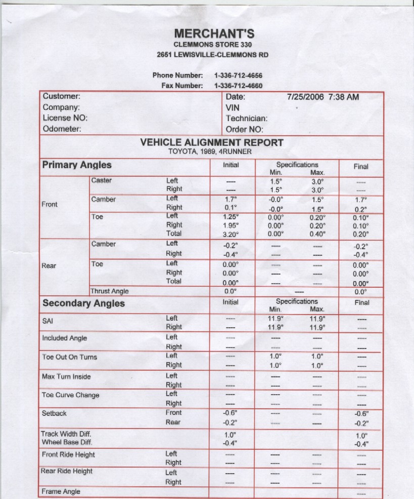

Something really bugs me though. Below is a scan of ths alignment spec sheet.
When I picked up the 4Runner (left it all day so they wouldn't be rushed) and askedt he guy for the spec sheet, he actually asked "You know how to read it?" I just smirked.
According to this, the camber was 1.7 deg off. Spec max is 1.5. Yet they didn't change it? why not?
I asked about this. he basically said 'well if it's w/in tolerance they just leave it". But it ISN'T in tolerance? Am i looney? it looks to me like all he did was adjust the toe.
I also asked why they didn't bother to fill in the other specs - ride height, etc. hell you could measure thsi w/ a yardstick. he just said "They hook it up to the laser device and it just does it all". To me this just says "our guy is onl yas smart as teh equipment we buy him."
Am out of line in thinking that somebody was just being lazy? is it normal to just leave out of spec like this? Somebody please tell me if so.
When driving home i could feel it pulling to the right on occasion. Not major, but noticible.
i guess what bug me more that anything is that I can SEE that the two left wheels are out of camber to one another. my vision isn't great. Seems to me that if I can see it, then it why couldn't a tech?
I figure I'll be going back in a day or two after more driving.
Yeah, I'd see about the camber it's barely off, but it's not in. I'd get them to make the front left close in measurement to the right front. I really don't think that would cause it to pull though.
You said you could feel it pull to the right on occasion. Could be little imperfections in the road along with a soft suspension, and off road tires with soft air pressure.The springs on my jeep are really soft and it doesn't take much of an imperfection to make it pull a little.
Make sure you're on a smooth, straight flat strip of road, and then put it in neutral and then feel for any pull. It should pull consistently, but not on occasion.

It's DEFINITELY pulling to the right. I drove it to work today (Baptist/WFU Med center) from home (lewisville) just to feel it out, it's 90% highway. It IS kinda funny that it's sometimes worse than others... but generally if I (carefully!) take my hands off the wheel it veers rightward. And this is in the left (passing) lane where the road crown is opposite.
Only other potential explanation I could think of, is it looks like 1 of the 4 pistons in the pass. side brake calipers has been sticking, the inner pad is worn more and unevenly (piston was tuck out). I worked it a bit while it was off though (pre-alignment fix) and it seemed ok.
However, it dosn't yank or pull rightward when braking, and I traveled the hwole highway distance w/o ever using the brakes. But, I think I'm gonna replace all the pads+that caliper just in case anyway.
I wonder if your rear axle is not parallel to the front? I guess you could measure, but I would think the hi-tech laser alignment machine would be able to tell you.
Gary
Interesting idea.
I wonder if that's what "wheel base diff" and "track width diff" refer to above? Eitehr way, they didn't do anything but measure it.
i just asked for "an alignment", I think at Merchants they do it all as one? No specification of diff in front/back etc.
But if you look at the chart, the back is only .2/.4 deg off camber... no listing of a spec, but if it's same as front then it's well within.
Sorry, i didn't mean for this to turn into "why am i pulling right", that would belong in another forum sectioin... just "is it acceptible to leave it out of spec". Although i'm open to suggestions either way, of course.
