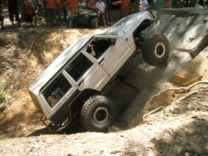

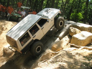

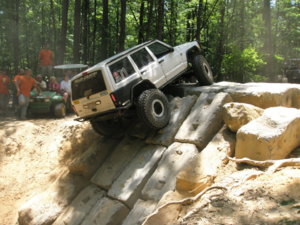

xj.... Take it out of bees nest then to the grocery store. I drive mine about 2 days a week Still has AC, windows, cruise, radio.
