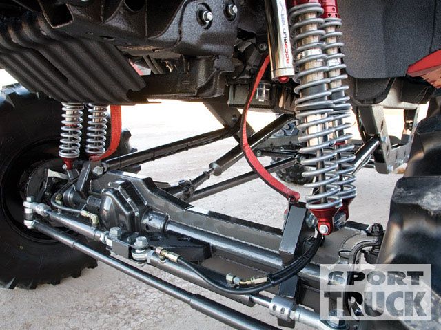

All show and no go. This was a SEMA truck.
wow---really a shame, but for some reason I still find it amusing.
looks like that just tacked the passenger side and forgot to go back and fully weld it.
lots of money in that truck, and more to fix it.

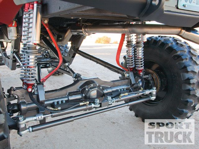

The shock mounts were not even strong enough to withstand the force to take it to full bump, they failed before the suspension hardly compressed.
Looks like it has only one bolt holding the two shocks on at the bottom, too bad you cant see the bolt head to see if its a a grade 8 or better
Exactly as Adam said, one bolt, two shocks, both in single shear.

Thats the same way the pro comp double cross dual coilover setup is for power strokes. Has a billet steel stud that mounts two shocks exactly the same way in single shear. There was all kinds of talk back when it came out about the same thing happening. I guess now they can see why. Whats even worse is most coil overs use a half inch bolt which even if it was an F911 bolt it can't handle that weight in single shear. Lessons leaned I guess.
