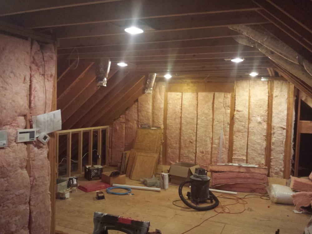

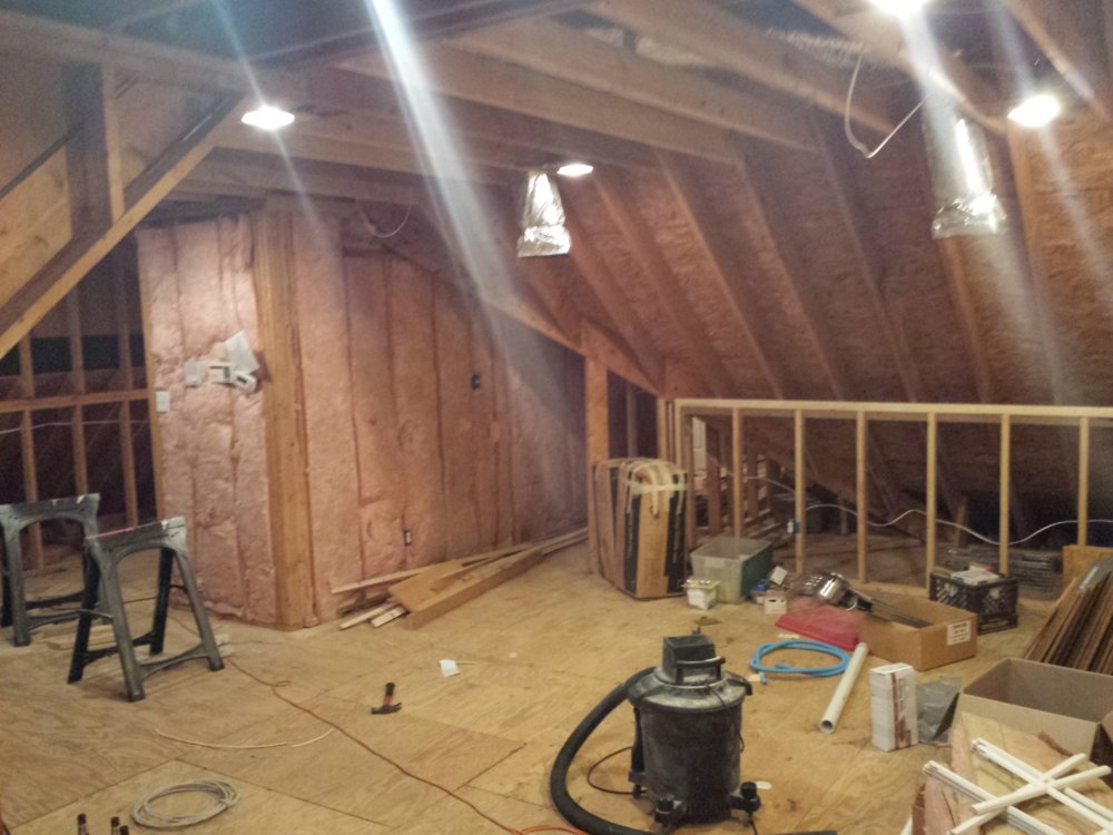

When we bought our house two years ago, the upstairs was unfinished. We had grand plans of finishing it off, but the business grew and I got really busy with it and it fell off. I had already finished the electrical and a lot of the framing, but stopped there. We decided to get some quotes on having someone finish it for us. It is a basic 550sqft open area with a storage closet on one end. There are a lot of nooks and things, but overall not bad. Framing is almost done, no plumbing, electrical is installed and inspected, HVAC is in, etc. Basically finishing framing, sheetrock, finish work, etc. Quotes ranged from $11k to $30k.
F a buncha that.
We talked about it and decided to take a couple nights a week and just start knocking it out. I took the quotes and started going down the list knocking stuff out. One of the things that needed to be done was to fir out the roof joists for the R-30C insulation since they are 2x8 and I need an extra 2" (insert joke here). Lowest quote to fir out the space was around $3400. I went to the store, bought about 400ft of 2x2 firring strips, spent Saturday gluing and nailing them to the joists and other areas that needed them. Spent about $150 in materials and finished it up. Tonight I am going to finish the framing, have one area that I need to add a couple boards, and then install the air barrier at the knee walls and then I'm calling for the framing inspection. Then I start sheetrocking.
Plan is to hang sheetrock and then pay someone to mud the space. I'm not about to do that crap by myself. Then I'll do the finish carpentry and paint, then have someone lay the carpet.
Here is the main space after I finished the framing and roughed in electrical. It pretty much looks the same now except 2" firring strips on the joists and a lot more construction trash. :lol:
If I had to make one comment, it would be to furr down more than 2". You need to account for air movement on the underside of the sheathing. I'd shoot for a minimum of 4" of clear space.

The reason I did 2" rather than 4" is because the walkways are pretty narrow and dropping to 4" would make it really awkward and cut into the room a lot.
I'm using a mix of faced and unfaced insulation. The previous owner left a ton of it here so I'm just using what I have before I purchase anything. The insulation you see there is what was put on with the house.

Had an inspector come out to give me a consultation to tell me what all I need to do to pass when I call them. He told me I had to fir our the joists, so fir I did.
Plus I only have under $200 in the firring, and my wife and kids carried the wood up for me. :lol:

Due to wetting of the underside of the sheathing. The dew point in that roof assembly during cooler periods (think winter or spring/fall at night) is going to end up somewhere just below the roof sheathing, probably in the upper inch or so of the batt insulation. Fiberglass insulation doesn't like getting wet, and neither does roof sheathing, so you try to provide plenty of room on the underside of the sheathing for air circulation. Ideally, you would have a ridge vent and a soffit vent to encourage stack effect in those joist bays, but having some air space there is better than not.
Those baffles are fine, but I would limit their use to down in the bottom corners where the ceiling insulation tends to block up the joist cavities. They're not tall enough to allow for sufficient air movement over a long span (which is why I lean toward 4" of clear air space if you can get it).
Most of the moisture is going to migrate up and out through the roof, so you want to pay closest attention to it there.
