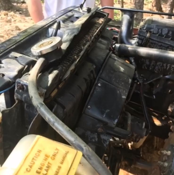

Attached is an image as to why I am replacing the current one...

Hey, that looks like the bottom of the stock one in my TJ! I replaced it with a cheap 3 core "heavy duty" brass one that never cooled sufficiently. Then I replaced it with a Novak aluminum "V8" radiator and have had no issues since. Fit, finish, function, and quality are all top notch. Had it since probably 2005ish, and it was $450 back then, but no regrets. These days I'd buy an ebay version aluminum TJ 2.5 radiator, especially for a 2.5L.

Shawn - I hated the stock one when I had it, I swore if it died I would put an aluminum one in it. It leaked around the "crimped" edge at the top and corroded. But I do agree that it did its job as long as it could.
