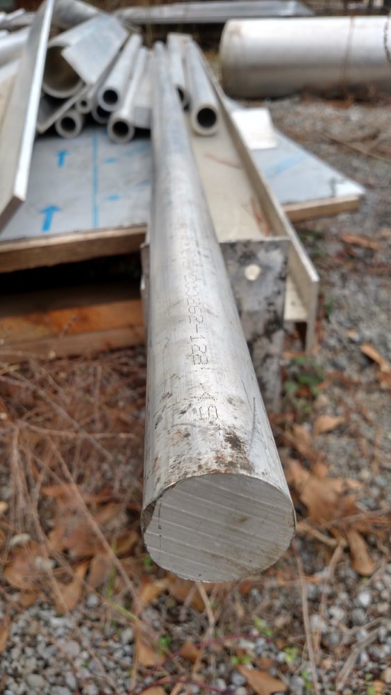

Back story: On my weekly trip to the scrap yard today I stumbled upon a piece of solid stock 1.5" OD aluminum 6061 while I was scrounging around for stainless and aluminum for a few projects around the house. It's roughly 8' long, straight as an arrow, and I was able to walk away with it for ~$20. Couldn't resist. Weighed in at 16#.

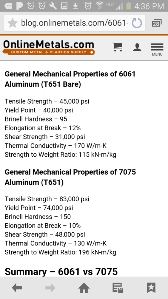

I was familiar with the 7075 used as link material. At half the strength of 7075 I may not want to risk it.

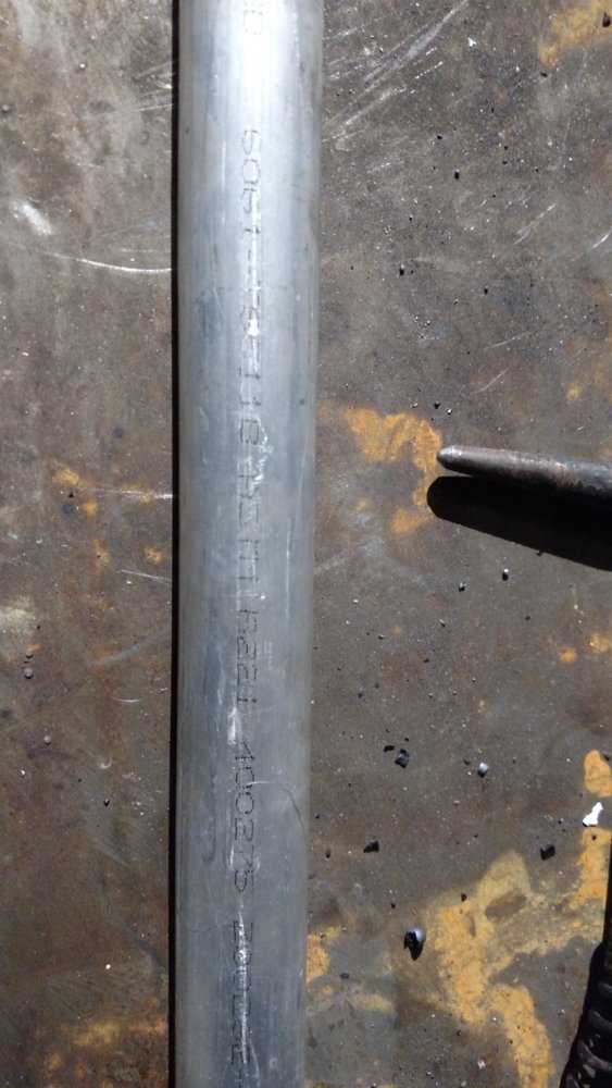

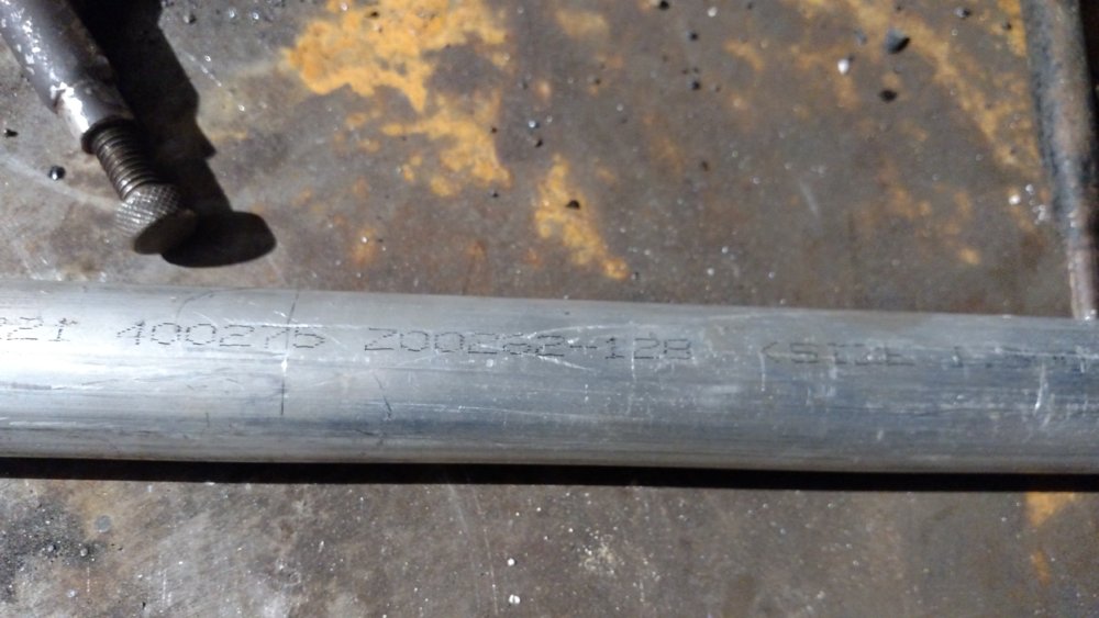

Find a temper condition marking on it, it should be part of that line of text. Don't use it if you can't find a temper, because you don't really know what you're working with.
Do yourself a favor and make sure you get a tap that properly matches the thread tolerance of whatever Heims you're getting for it. This is important. Don't just grab one out of your Craftsman tap kit.
And worst case, there are other things you can use it for....
Hmmm... I'm no good at deciphering these codes really.
KaiserSelect made in USA, precision rod.
And no worries on having a good tap. I've got plenty. If not, I can get ones I don't by chance already have.
6061-T651 is that part that is important, in the second picture.
T651 is similar to T6 temper, but T651 has been stretched after extrusion to relieve residual stress. Treatment after that is the same as T6 if I remember correctly.
Yeah T6511B is the complete reading on it.
Oh, that's actually slightly different than T651. T6511 is generally straightened for tolerance, I think that's the only difference. Doesn't really matter for what you would be doing, as the shape between the Heims isn't important and it's going to get bashed anyway. Good piece of stock for $20 though.
