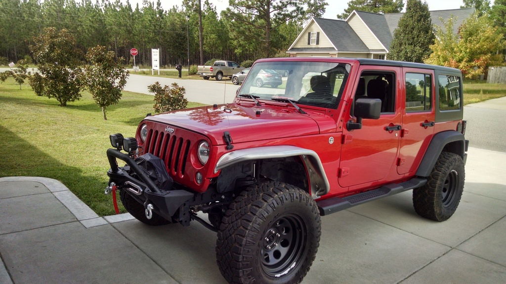

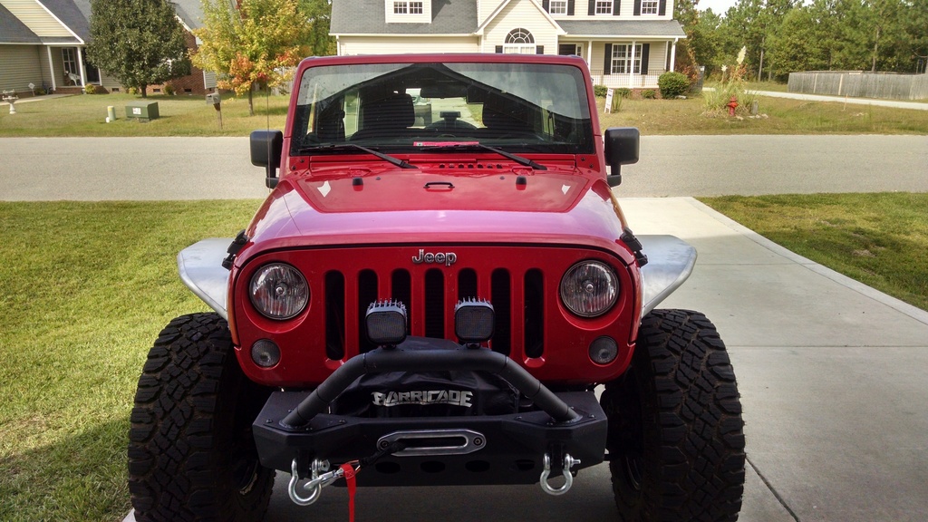

Just an update after install, still undecided on to finish or leave bare.
ai1294.photobucket.com_albums_b604_dirkwadeparsons_Mobile_20Up87e3fe892487ffd7a7e999d6ecbdedca.jpg
ai1294.photobucket.com_albums_b604_dirkwadeparsons_Mobile_20Upf7b3c7b05402d1761aa7af3bbffbda5e.jpg
Go to aluminum on the rears and running boards/sliders and I think it would look pretty sharp. Right now, it looks unbalanced. Potentially, you could plasti-dip them peel it off later if you decide to go raw with the rest.
