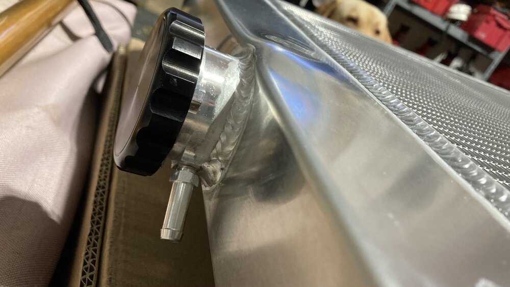

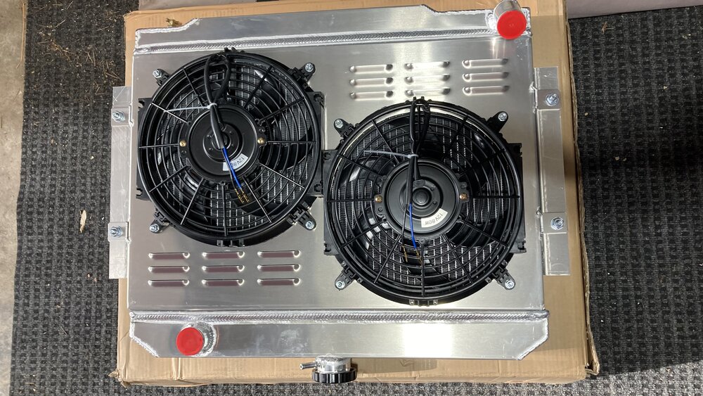

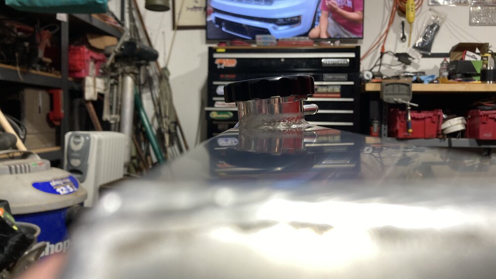

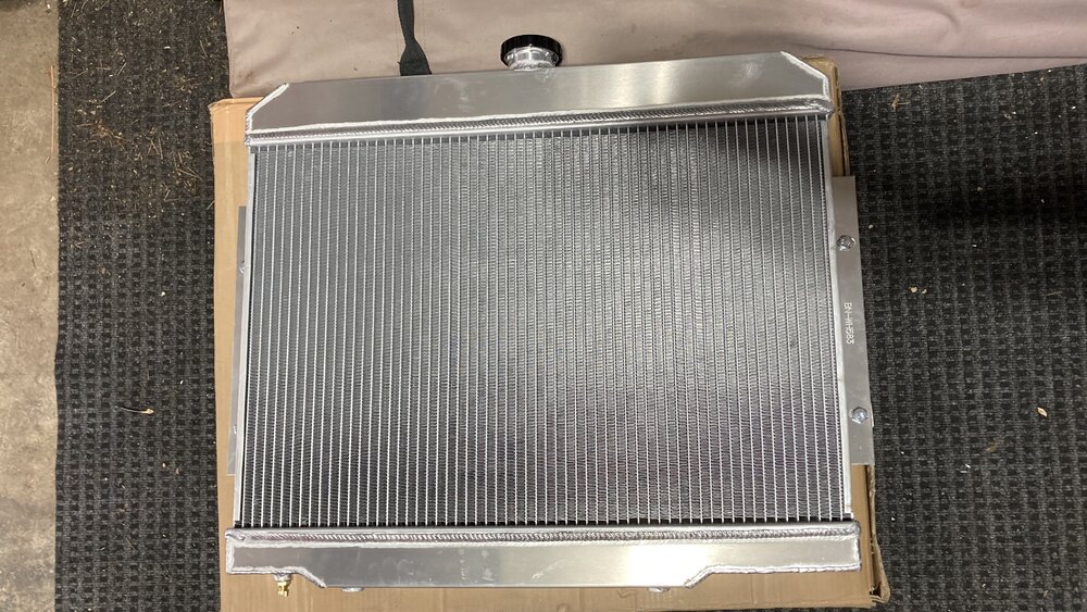

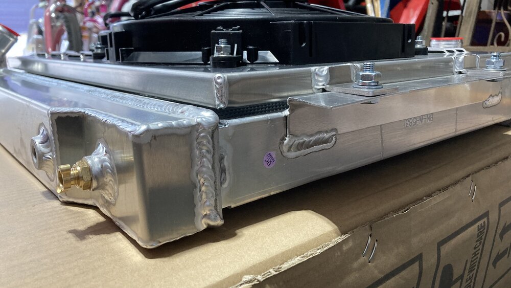

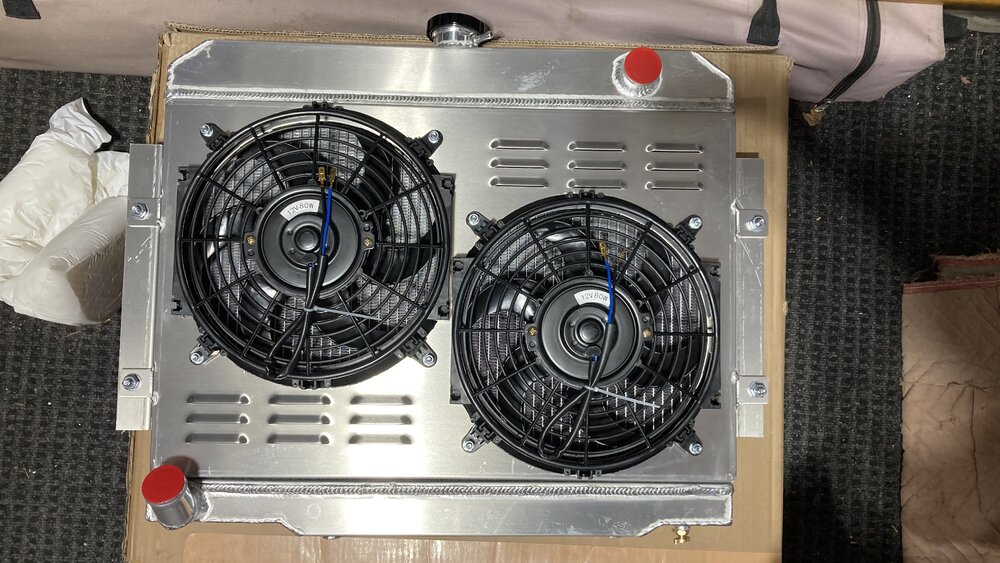

Got the radiator in and damn, thing looks good! Buuuut it got damaged in shipping so it’s getting sent back.
