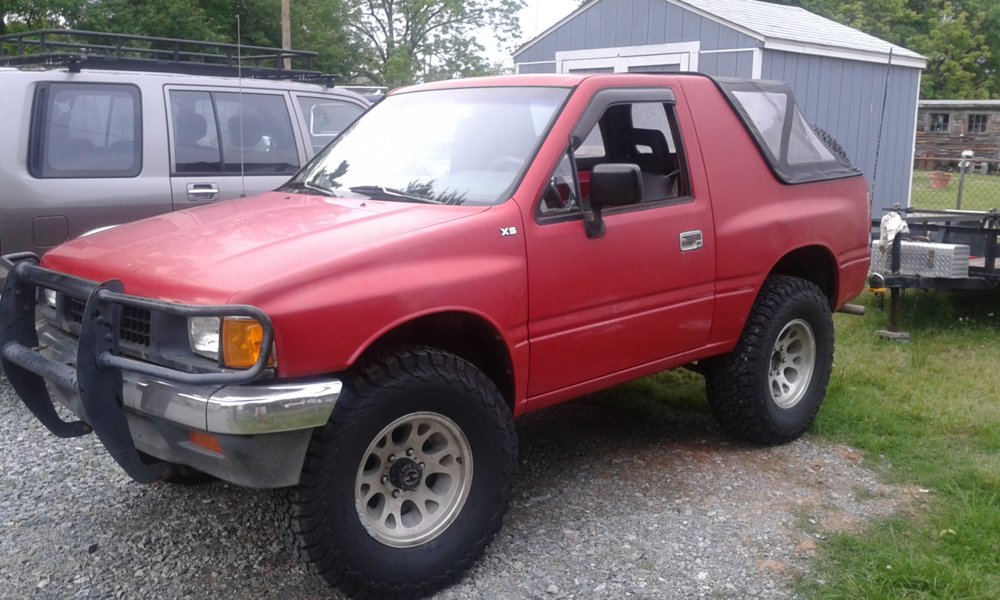

Soooooo I'm picking up an Isuzu Amigo soon and am already tire shopping. What bolt pattern wheel do I need (stock ait gonna cut it)? I heard a Chevy 6 lug wheel will work but dunno if its true or not. Hoping the Isuzu guys on here can help me out
The wheel that works best on all Isuzu's for bigger tires and a great offset are the 16" Honda Passport wheels called "snowflakes". They look very similar to the 15" variation that came stock on Amigos and other Isuzu's but with a square holes in the design instead of round ones. They are 16" by 7.5". Here is a set on my wife's Amigo with 285x75x16 BFG KO2s.
