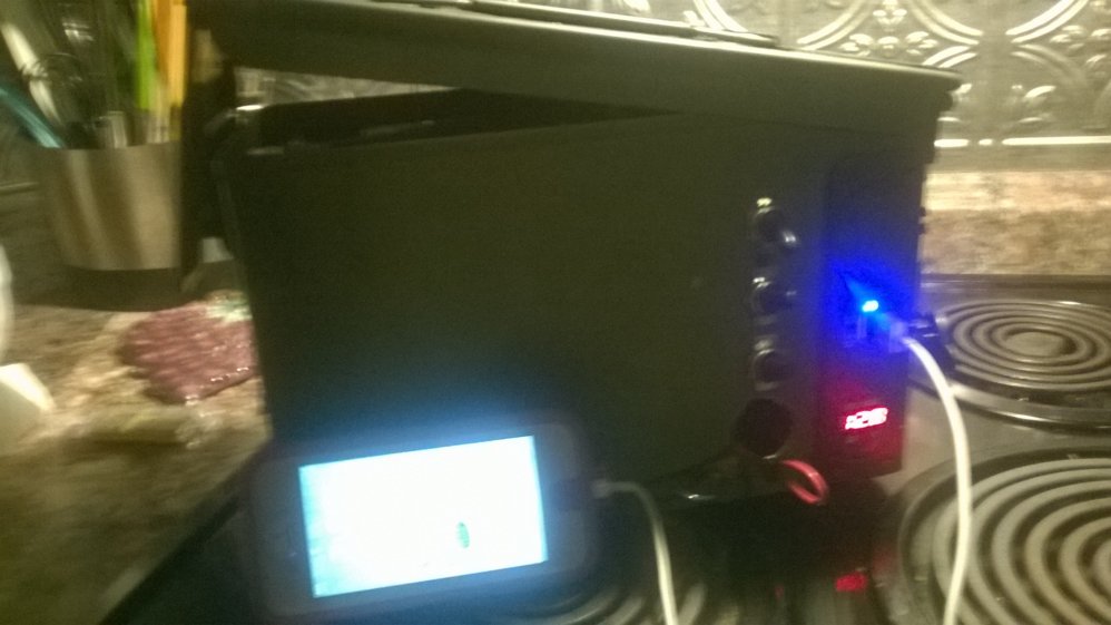

NWNC

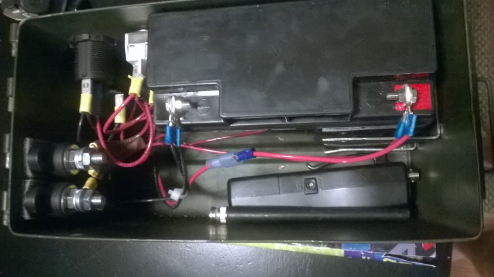

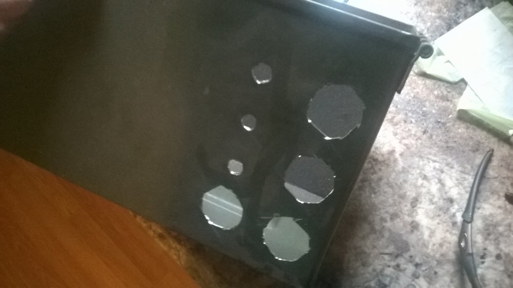

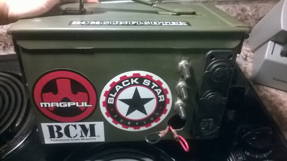

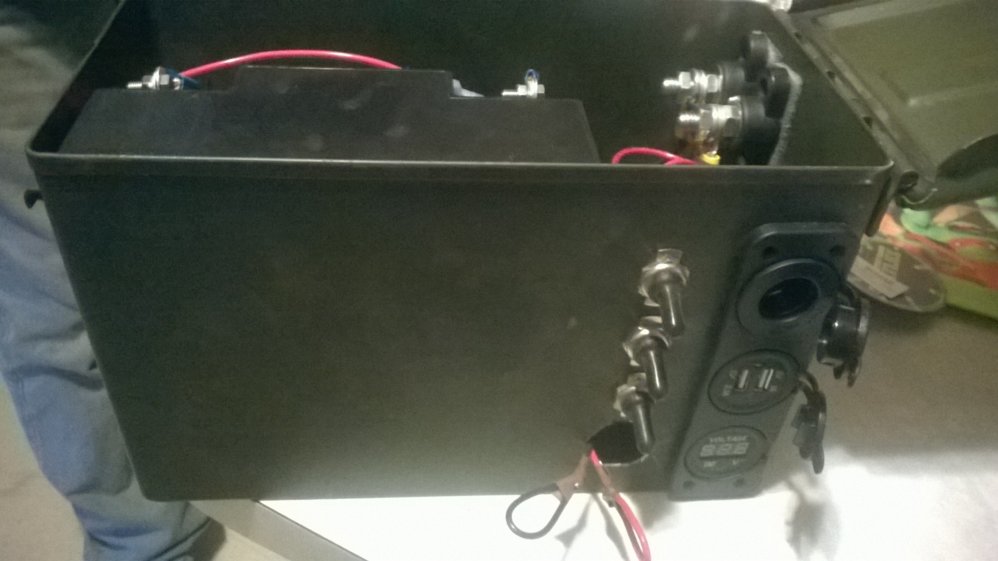

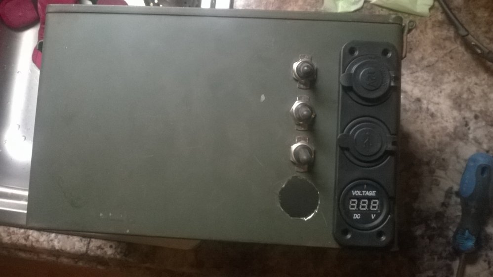

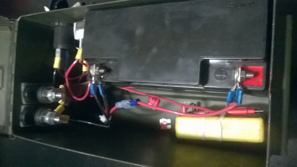

This is my lights out, zombie apocalypse, natural disaster 12v charger I built and still in the process of building for under $150 but will go over by about $50 after i buy the 150 watt solar panel. I have right at $90 in what you see below (minus a few things). It consist of .50 can, 12v 18ah battery with room for another one in parellel for double the aH, 3 dpst switches for the option to add other accessories, solar charge controller, double USB charger, 12v outlet, volt meter, 2 terminals and another 12v outlet for charging the system. Things still to do is add the solar charge controller, 12v outlet for charging the system and an inline fuse, which i am waiting on all that to arrive in the mail. In one of the pictures, it has my scanner and i can also add my 2 way handheld along with a few other small accessories for the radios. I measured for the solar charge controller as well so i know what all i can fit in the can. Also, its not complete without a few gun stickers.
