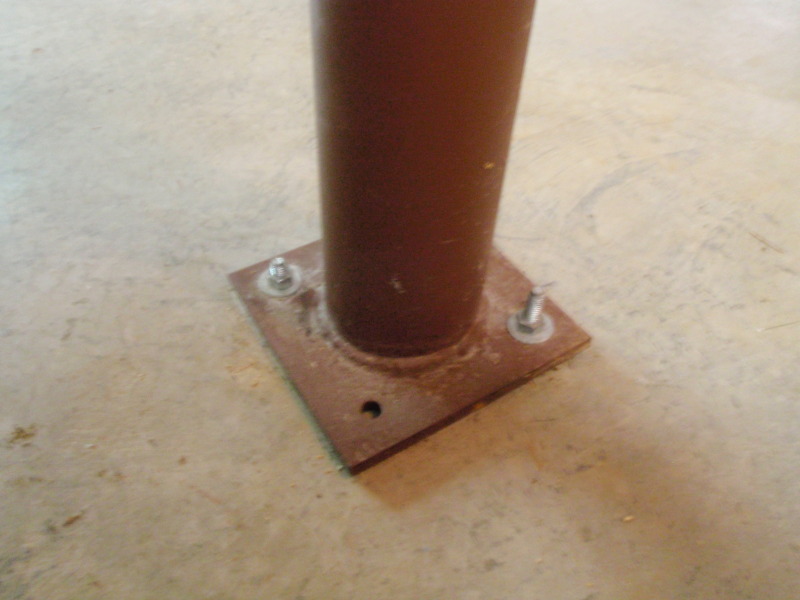

I've got three steel posts in my basement that support beams for the floor above. One of them has two bolts holding it to the concrete floor, and the other two have zero bolts. I've never attempted to bolt anything to concrete before, so this is new to me. What tools and parts do I need? I'm thinking that I need a hammer drill with a masonry bit and then some kind of anchors the slide into the holes in the concrete with bolts that expand the anchors so they stay secure and tight. Looking for advice on how best to do this.

Looks like the holes in the plates are too small for wedge type anchor w the same size bolts so you may need to drill them larger first. Plenty of sizes of concrete anchors at Lowes or H depot and a 1/2 hammerdrill will be needed to drill the concrete. while your shopping, Get a bit/bits sized to match the outside diameter of the anchors that will drop into the holes you drill, might have to hammer them in w a bar or the bolt screwed partly in they should fit a little snug not wobbly, Might want a vacuum handy to suck up the dust and or blow out the holes before the anchors go in. You should be able to use bolts stuck down in the holes and the anchors w a large washer under the heads maybe a lockwasher too. You'll need to measure the anchors and the bolts to be shorter than the holes you drill in the concrete. You can wrap tape around the bit to mark your desired depth, should be a little more than the lengh of the anchors.

Tapcons would work too. Just something to keep the post from moving side to side.

Honestly for your application, you could just drill holes in the floor the same size as whatever bolts you want to use, and just drop some bolts in with no threads. If a tornado blows your house away, the anchors won't hold it down anyway....

2 (ea) 3/8" Tapcons would be plenty. Add washers if necessary.

I like drop in's too, but they require a larger hole, and in this case, he could use the wedge anchors or even tapcons without moving the poles. I'm not a fan of tapcons, never had much luck with them.
Regardless, we're picking this to death. Any of the above will work. All require basically the same process. Drill hole, insert anchor, tighten.
