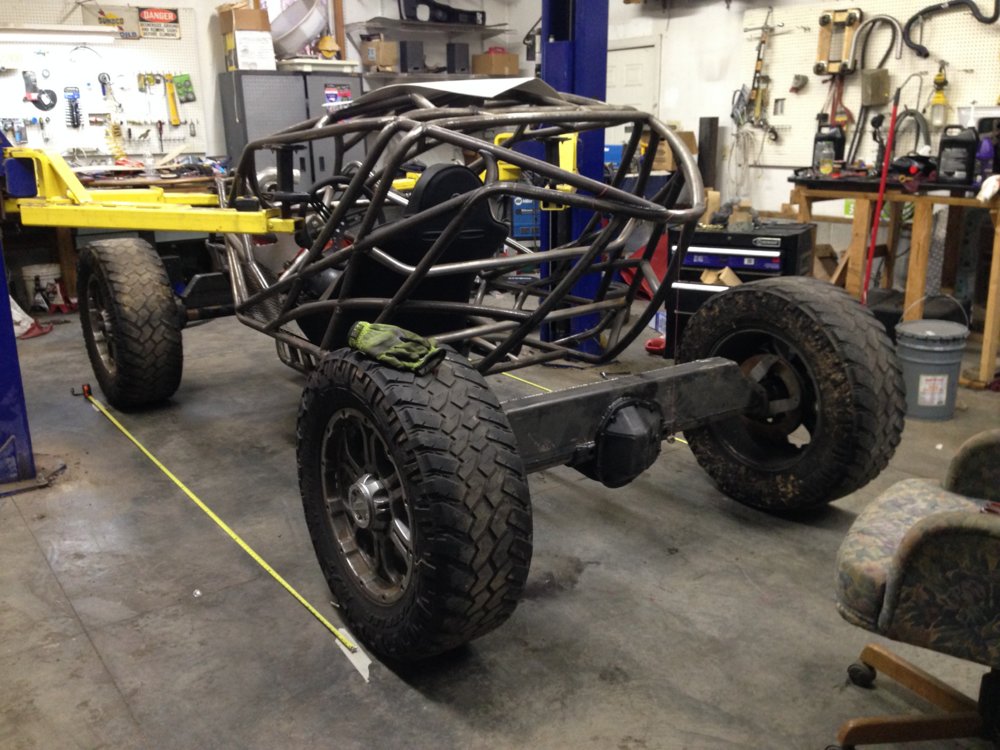

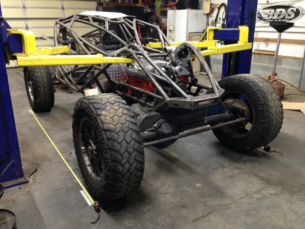

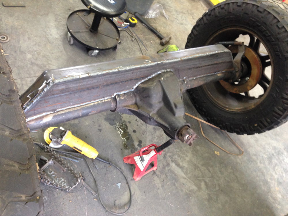

A lil truss work today. Nothing fancy but I'm sure it will do the job. Finish welding the setup everything to do the 4-links.

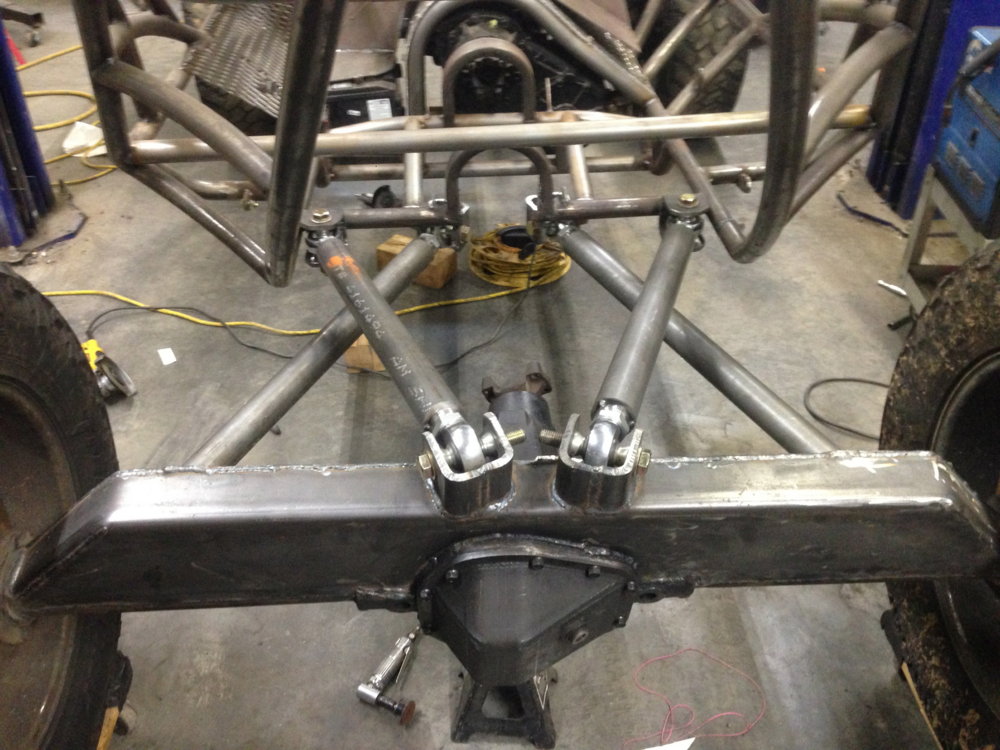

Got everything setup and measured out. Made some big thick brackets and start all the fun tomorrow.

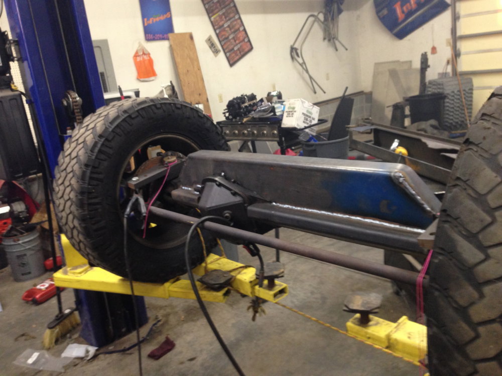

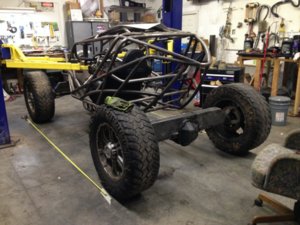

Thanks! Matt, cycled pretty good. I will try my best to explain, bare with me haha. The back is stiff(don't walk at all), when cycled bairly rocks driveshaft no more than 1/2inch side to side driveshaft-wise. Couldn't get any closer on bottom link bars at frame. Setup pinion agile to stay pointed straight at Transfercase throughly all movement. Thought about extending all rear bars about another 2" but will see how does first.... Front, did the best I could with everything. Don't walk at all which I was worried about due to couldn't get too much angle. All in all I think it will work and pretty sure when done bracing it won't be the weak link in the equation. Shock wise saved all last year for these babies

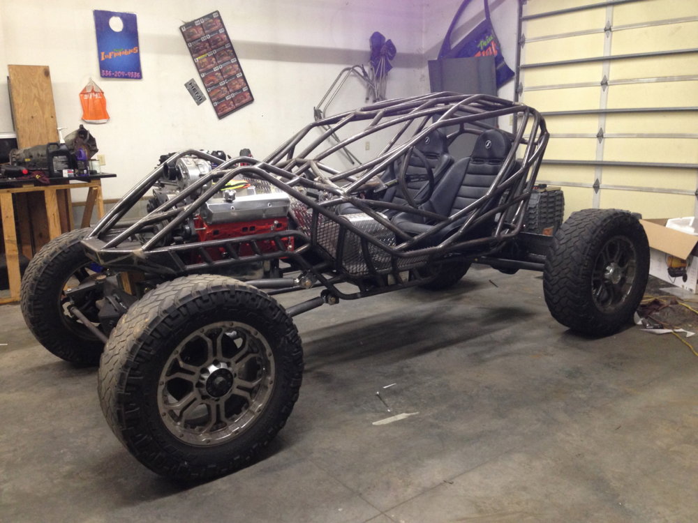

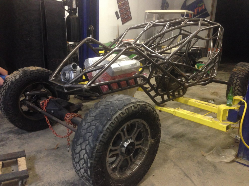

Belly sitting at 19" with my lil 34" rollers on it. Wheelbase is 117" as of now. Going to finish up shock mounts then going back to floor pan. Not happy with it at all. Was my first try and not the foot room I like nor the fab work. Watched a guy on youtube do a technic that ima try.

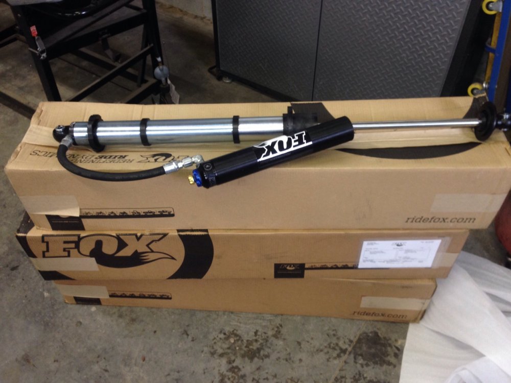

Also anyone got any pointers on spring rates??? By the calculators showing roughly 130lbs front main, then run a 180lbs secondary. Is That sound right? Then how you know what lengths to go with? Probably call PAC tomorrow.

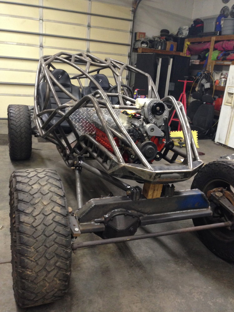

Sorry Guys,,, NOT FOR SALE AND NO DIVORCE hahaha. That wasnt me. Been busy putting money in my f450. About to start back on the bouncer, picked me up some goodies in Kentucky the other week!!!
