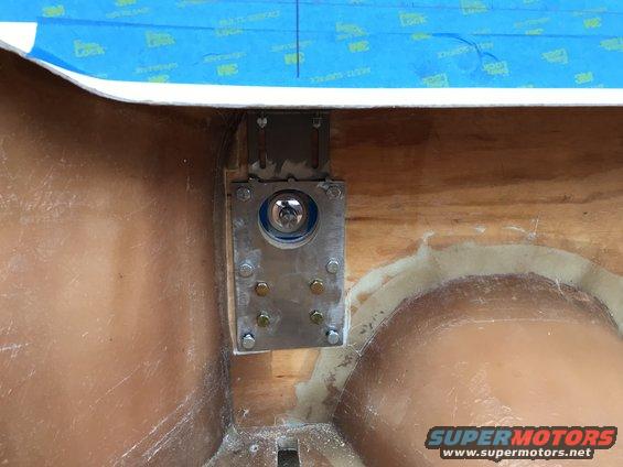

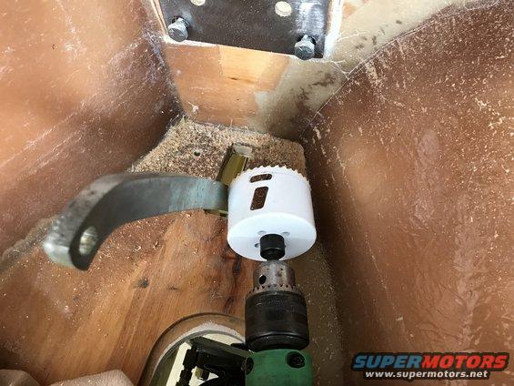

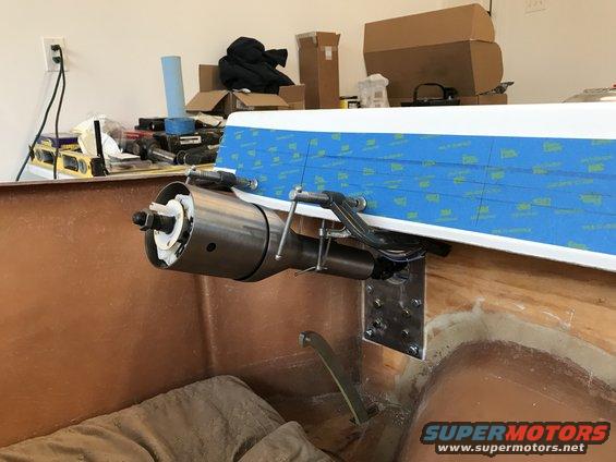

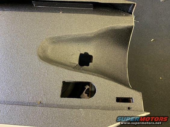

I was nervous on drilling a rather large hole in my firewall but all went well. My next effort was drilling 4 holes straight enough that they would line up with the Steer Clear box. My plan was to use the box as a guide but the box was in the way so I had to freestyle it. I also got an assist from the wife. We nailed it perfectly!

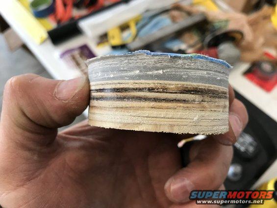

I was not expecting the fiberglass to be this thick on the firewall.
Now that the box is mounted I could mock up the steering column. I was worried the column and steering joint wouldn’t connect but you couldn’t ask for a better fitment and spacing.

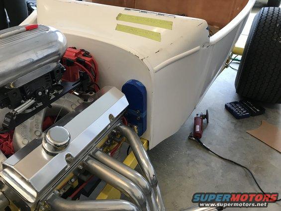

Now for my brain fart. I unexpectedly had to clearance the side of the block to allow room for the Steer Clear box. Well I was concentrating on working the block that I did not notice I had gotten against the frame! :kaioken:

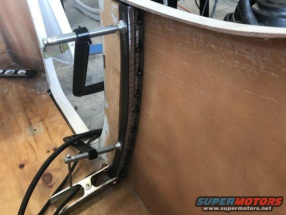

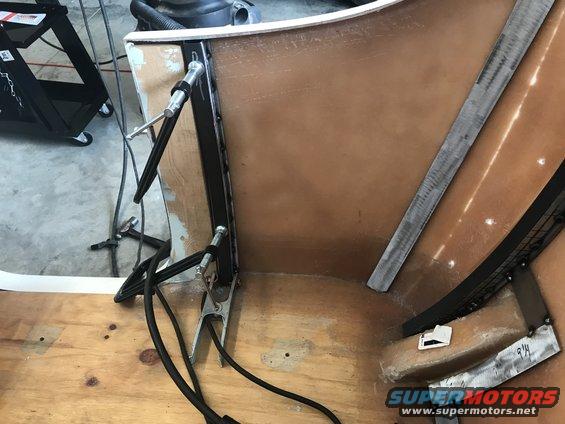

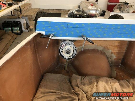

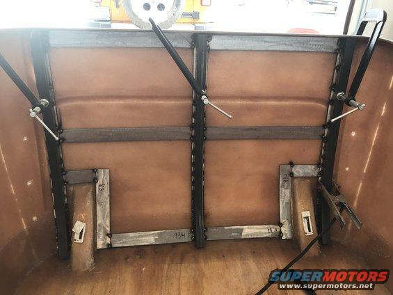

I’ve been working on building a metal skeleton to bond to the fiberglass body. The interior guy said I needed to reinforce the body or the paint would crack. Another one of those details the assembly instructions failed to mention. I am learning he instructions leave a lot of holes in the assembly process.
Almost done with the back of the cab. I need to cut some 1” square tube to and form fit to the horizontal flat bar. I’ve been relief cutting the square tub so it would form to the body shape.
