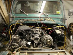

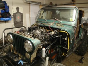

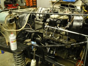

So the 6.0 is in the bay, and it fits. Sitting 3" over to the pass to try to take away vibes from the far offset 60 rear. Going to use the stock van manifolds, they fit- just removed to make the mounts. Took forever to get here. Lots of good info on the net, but when you want to use a 700r and a VSS it gets interesting. The small T.C. pattern on my 700 would not mate to the flexplate and the VSS tone ring/pickup had to be custom added to the 700/300 adapter. So, thats sorted and now on to the other pesky crap that couldnt be found until its in the bay. But thats what I expected I guess. I am already diggin the electric fan, just looks cleaner.
dang, the york is in another zip code. didnt look that bad on the stand!

keep the pics coming , lookin good :popcorn:
