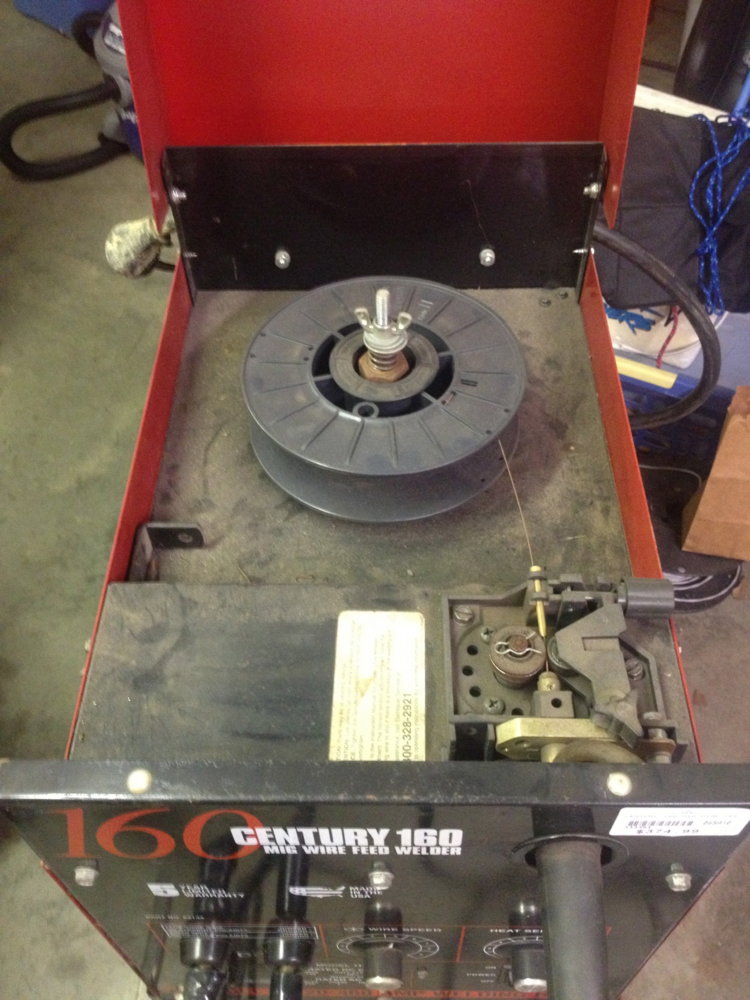

I found a Century 160 mig with tank for under $400.00. As far as I can tell, it looks pretty good and has a rated output of 130 amps @30%
Would something like that be good to get?

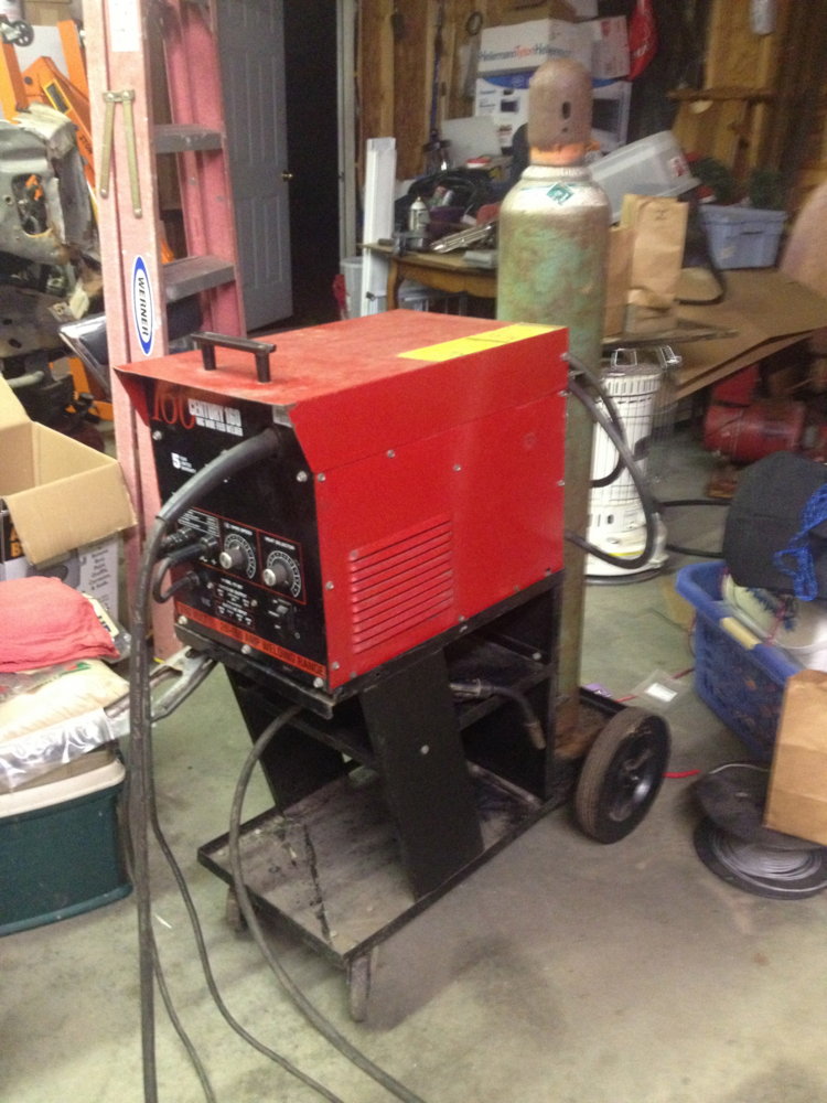

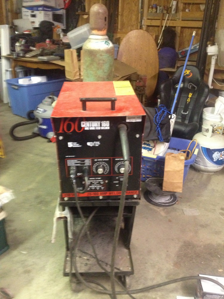

Maybe I shouldn't have, but to me it seemed a good price at 375.00 with tank so I went ahead and bought it. I got a receipt and the guy told me it had a 30 day warranty. Will have to wait until Saturday to wire up a 220 outlet in the garage, but then I'll do some welding with it and see how it does.
I figure if nothing else, I can throw it on craigslist and get my money or a little more back.
View attachment 54882View attachment 54883View attachment 54884
I actually like the way a century machine welds. I think they are one company that has a bad rap that shouldn't. Other than parts being a little hard to get, I think you'll really like it. And when I say parts I don't mean consumables I mean things that "could go bad" like the wire feeder motor or the control board. Tips for that machine should be the same as tweco and the century's I've messed with have a push on nozzle that interchanges with the lower end Lincoln's.

Actually in the picture it looks like you may have a tweco mini gun which is what I use on my machines and love!
Sent from the MarsFab Off Road mobile response unit.
Ok that's good to know, I'm still pretty new to welding. I know a few techniques but I know there's a lot more to it. I was mainly looking at a Hobart 140 handler, the funds aren't able to get anything much larger. Thanks for the info guys, sorry for the hijack.
