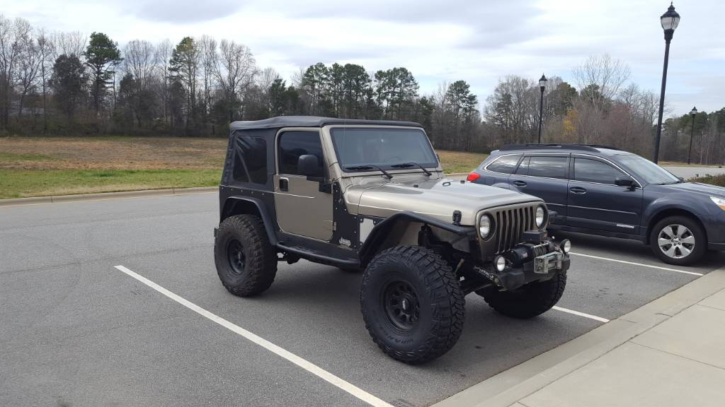

My arms are level at ride height. All of the pics I have are not on flat ground.

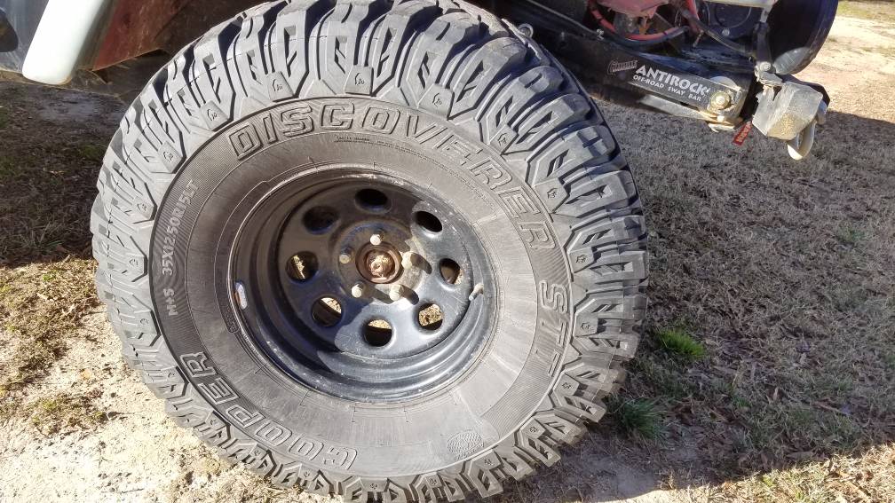

As you can see, I run in the second stiffest hole on the street. No rear sway bar and it feels good. I did have to cut my links, but only because it's a stock height suspension.

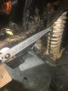

This how my arm sits on level ground. Jeep has 4 inch lift. I believe it's in the second hole from the front of the jeep. I can get a better picture and length tonight when I get home.

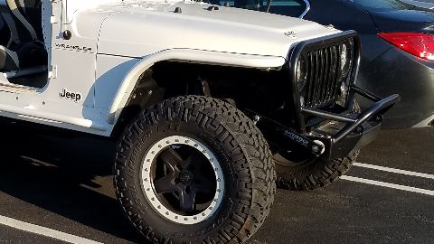

I ran mine without cutting any threads off. Just tighten the rod ends down as far as they will go. Mine goes up at an angle all the way out at the last hole and I haven't had any issues with it set up like that. Running 2" lift springs.

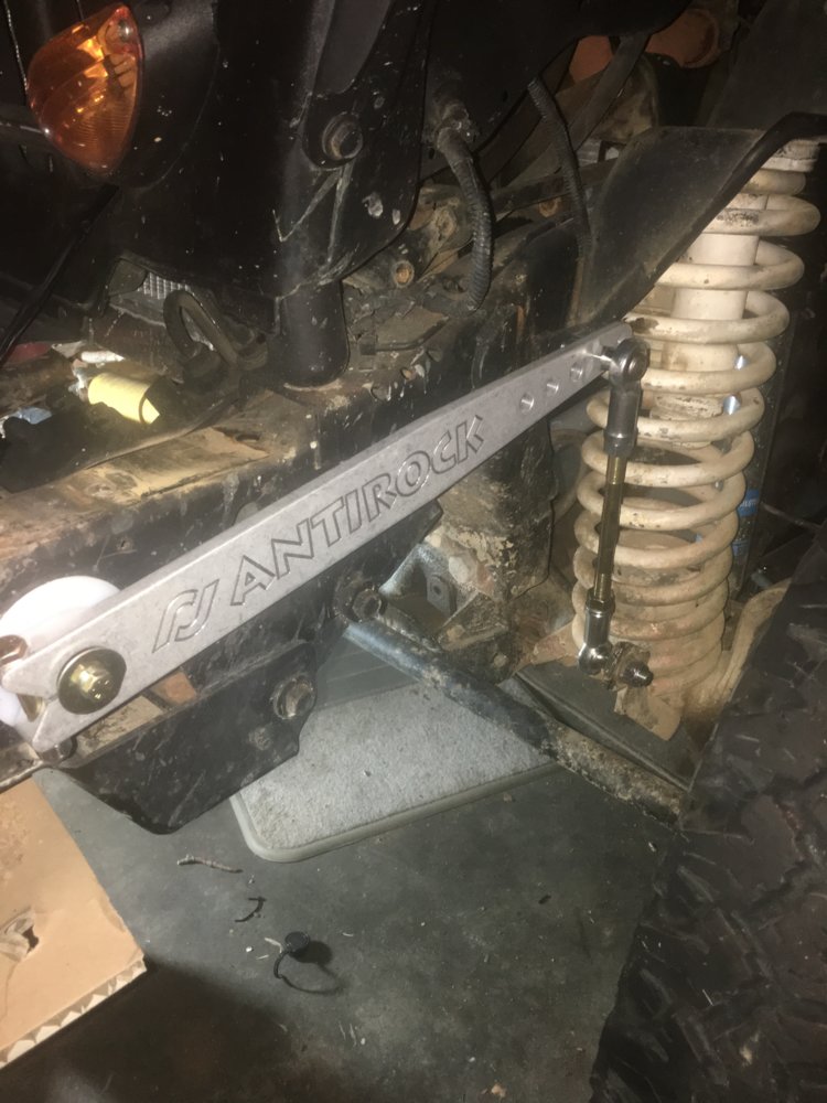

I'd shorten them. If you look at how they're set right now, the tire probably gets into the spring bucket when it's stuffed. When the tire is that high, the sway bar will be, too.
Good point. I didnt cycle the suspension yet, so that will probably prove you right.
To shorten them more I am going to have to cut some threads as that is with the joints tight as they will go
