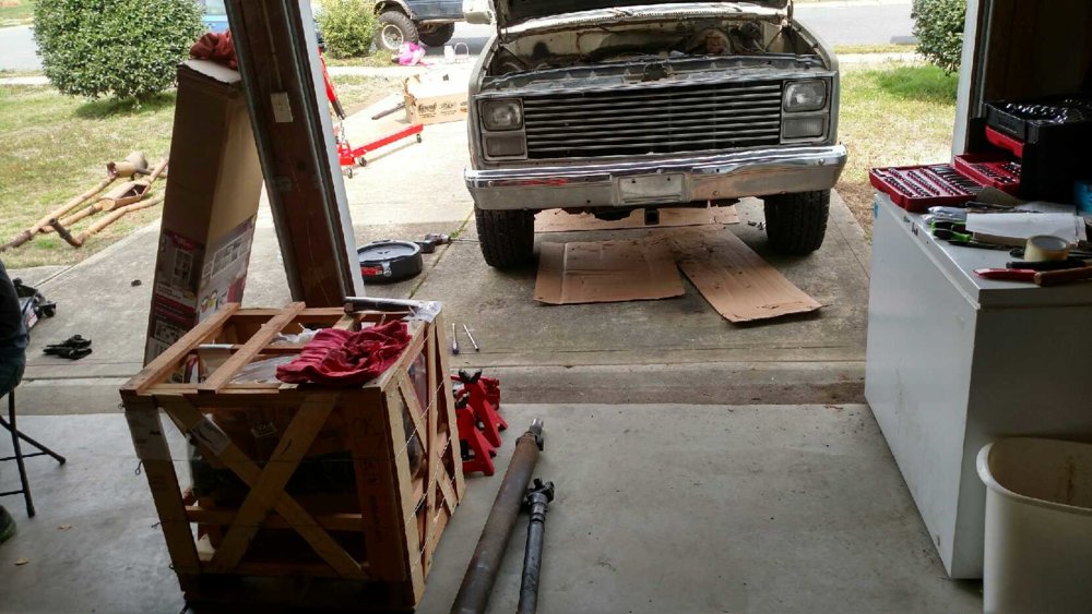

Just a quick update. Lorenzo stopped by this weekend and we got a ton of work done on this truck.
We snapped a few pictures of the progress.

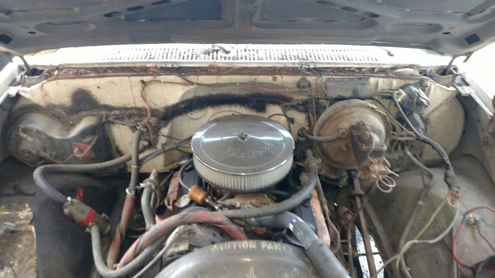

Here are some BEFORE pictures.

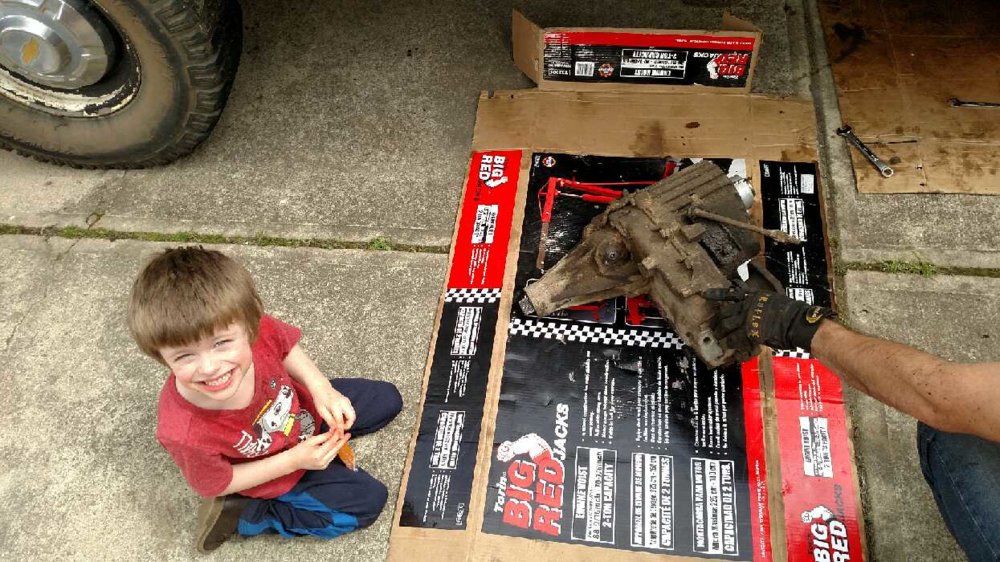

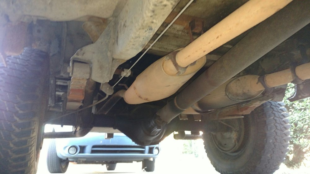

On Saturday we removed the exhaust from the headers back, both drive shafts, and the transfer case, then started to tackle the actual engine.
My four year old wanted to help

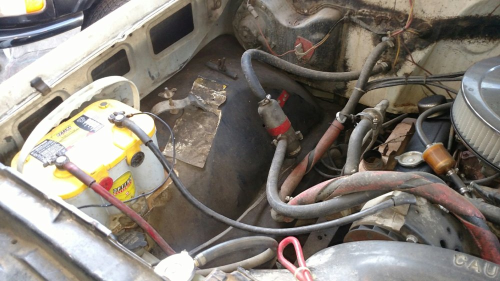

We were a little confused as to what that tube was in the upper left hand corner. If you look closely, it's powered by a 110v AC plug and connects to the cooling system. I know that the previous owner used this truck for camping so we were curious if this wasn't some sort of heater. I'll have to do some research.

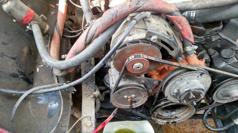

We got most of the accessories off, including the starter, belts, radiator, mystery box.
Overall is was a good start. Given that the truck is almost 35 years old and much of this is OE, the work was relatively easy. Still a lot of work to go, but definitely a good start.
Looks like a coolant (jacket water) heater.

@Ron , yea looking at how that thing was wired, it looks like it ran the water around the blower motor/heater core when the cord was plugged in.

If its what I think it is (something like: https://www.hotstart.com/assets/Catalog-documents/TPS-heaters.pdf)
It probably doesn't circulate anything at all. Just a heating element.
Very common on industrial diesel engines, less so on spark ignited.
I know an old eccentric engineer who installed one on a suburban simply so he would have heat first thing on a cold morning without having to warm his truck up outside the garage.

This thing started life as an Idaho forestry truck, maybe they thought it would help in the winters?
yeah in 20 below they can be neccesary to crank.
