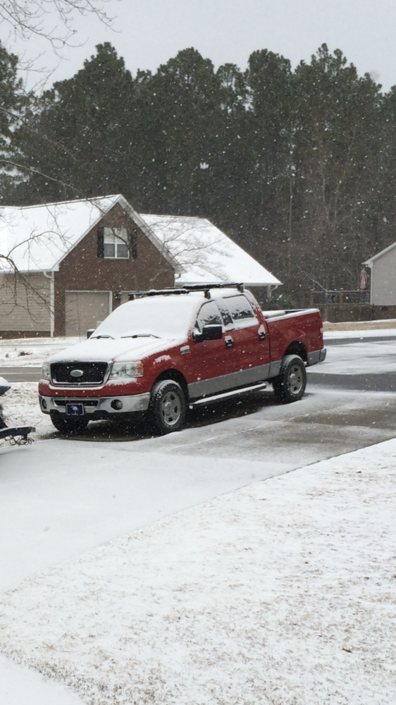

I have an 07 4wd Crew Cab XLT. Bought it with around 60,000 on the clock. No real issues other than the spark plugs so far.
It has about 130,000 miles.
Normal maintenance. Brakes, oil changes, air filters, ....
I did replace all of the coil packs to fix a sputter, but it was just a bandaid for needing to replace the plugs. The 3rd brake light leaked inside the cab so I siliconed it to seal it. The rear pinion seal was replaced. My 12v charging port up front quit working. It’s got a few dash lights that need replacing but other than a few ankle biters it’s been a great truck. About to throw a leveling kit and some exhaust on it and drive it till it breaks which I hope is another 100,000. Appearance wise, it’s held up nice minus the ford emblems front and back fading out. I’d definitely buy another. The only pic I have is when it snowed several years ago.
