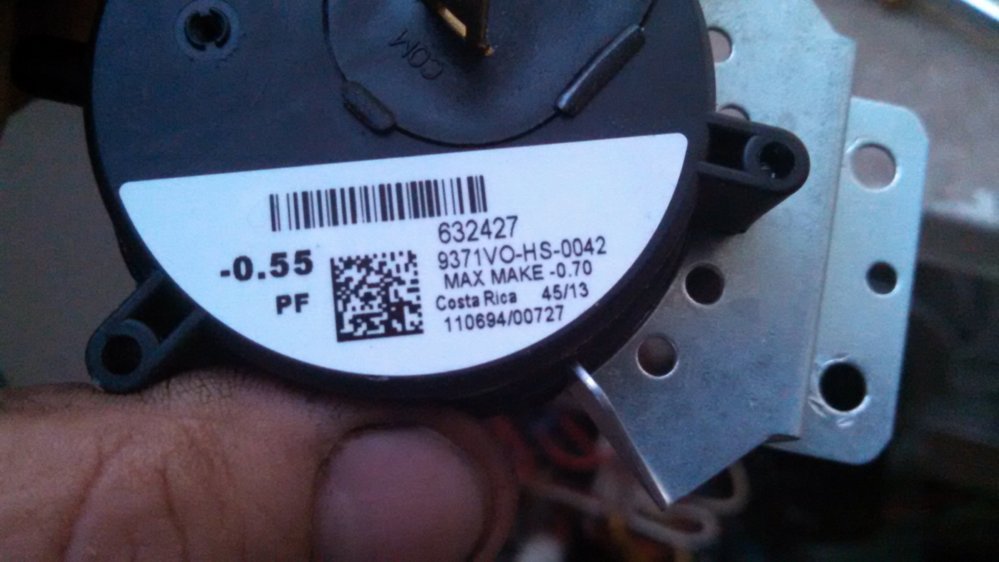

2002ish gas furnace, fan runs but no heat. The inducer motor works and there is exhaust out of the side exit of the unit. I get a code 4, pressure switch stuck open code.
I tested the following:
tube from inducer to pressure switch is good, no holes and not clogged
inducer "nipple" is not clogged all the way into the inducer housing
the pressure switch "clicks" when vacuum is applied
The thermostat in the house is set high enough to turn the unit on
Same thing happened earlier this year (January) and I replaced the pressure switch and it has worked fine ever since. Until tonight.
I wonder if I got a crappy switch or if something else is causing it?

New pressure switch (warranted from January), removed inducer, thoroughly cleaned the flue, new hose, verified the circuitry is good. Appears to be a bad circuit board.

After a ton of head scratching, I found out the manual that I *thought* was for my furnace was for the ORIGINAL furnace and as such the code numbers didn't match up.
My code 4 indicated an ignition failure. I tested the ignitor and found it to be open. Replaced it and good to go.
