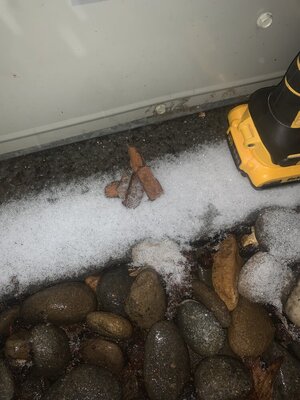

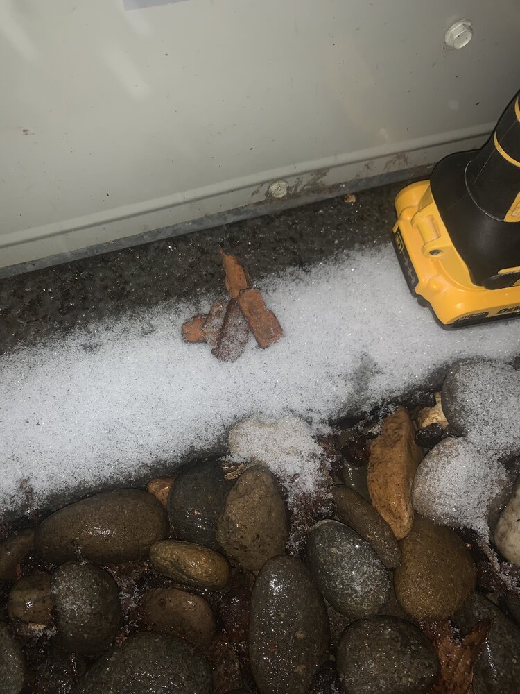

Update… as I typed my last reply I guess the vibrations tore it apart, only 2 blades remain and not enough air to trip the pressure sensor. Based on the picture it appears to have been spitting blades out for a little bit now.
