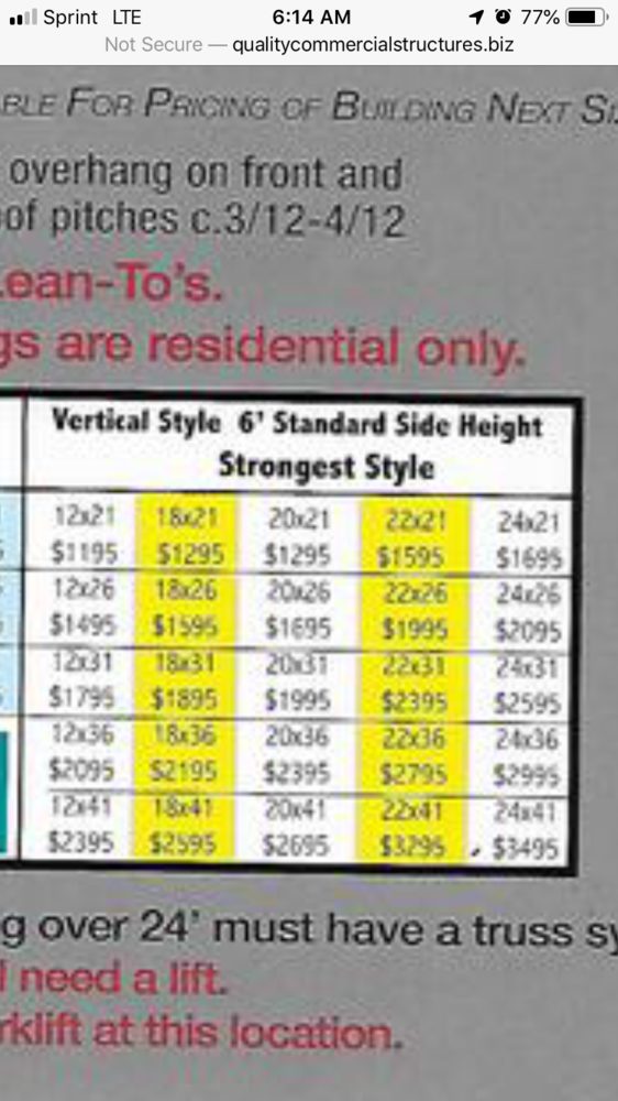

I was looking at the the ones from this section. The lady in Shelby that I talked to sent me a picture of the pricing. The company they buy from was from Asheville I believe??
dang that's cheap for 24x24 vertical style...go for it. spend more money buying extra tubing on your own for extra bracing if they don't offer the extra...it's worth it with the winds and "possible" snow load we saw last year LOL. if it's in the budget, get everything 4ft OC rather than 5ft...that alone ads a lot of extra beef.

That’s the company on the picture of the price sheet she sent. Ever hear any nightmares about them?
sorry so late, I don't get on the computer much these days. I haven't heard about them so couldn't tell you.
