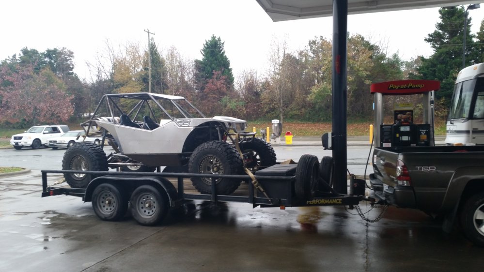

I'm looking at getting one so the wife and kido can come with me to Harlan win rock places of this nature my buggy is very small and light it's all toyota drive train 105 inches wheele base 76 inches wide and weighs 2600 pounds wet . What I have found us a jayco octane 222 it's 26ft long and cargo area is 78 inches wide and has up to 13 feet of space depending on wich layout I choose they claim 4600 pounds dry and gross is 8k and I have a brand new tundra tow raiting 11k I'm not new to trailers but have never owned any thing of this size any advice would be awsome is jayco a good company? are there any other big questions I should be looking at I'm buying new I have got a few dealers down about 20% from msrp still trying to do a little better thanks in advance
