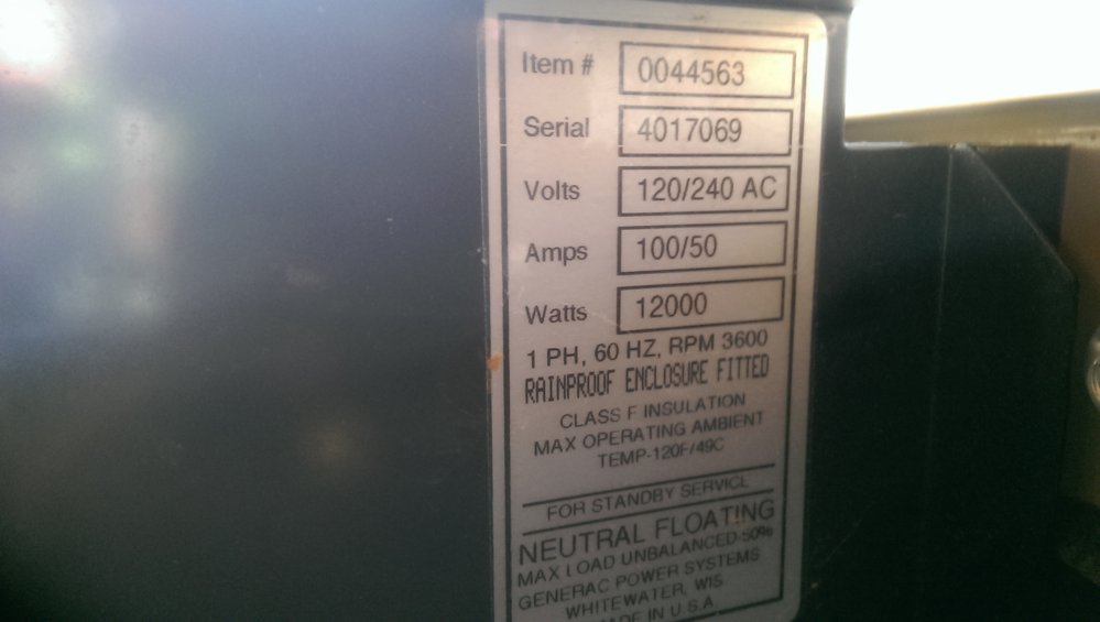

It is a Generac 12KW . I couldnt find a model # number but I found an item # (probably the same) and a serial #
Item # 0044563
Serial# 4017069

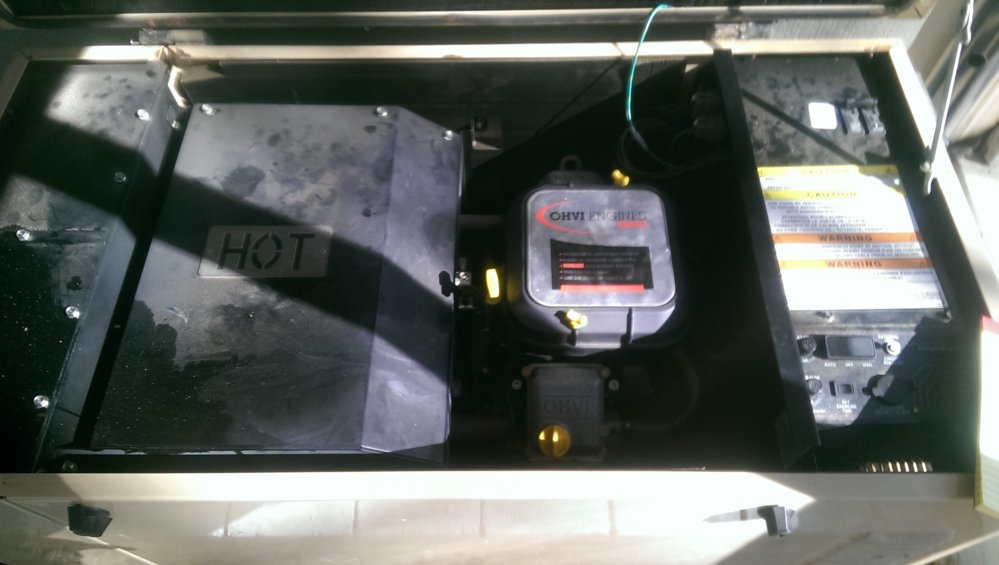

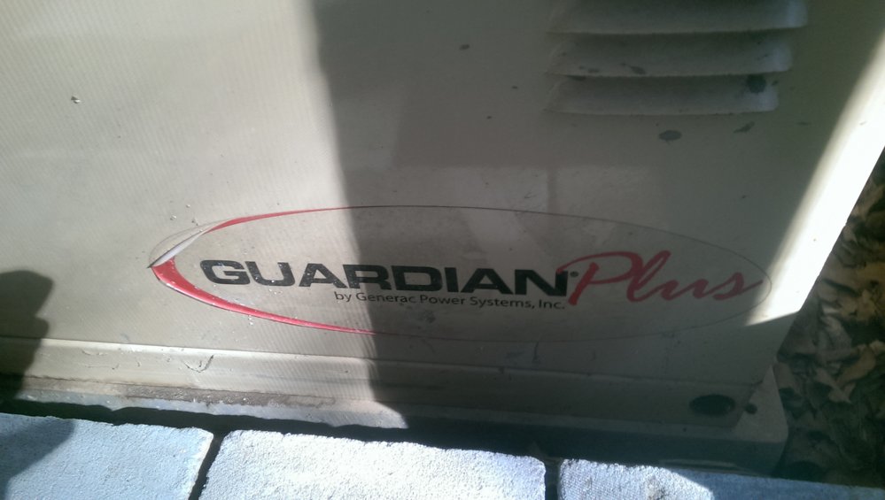

Got a little more info from him too. He has had it for 10 years but has never had it serviced. He did have another guy come and look at it recently and he changed out the plugs but did nothing else. I told him that I thought that you worked on these type things and he asked me to find out if you would be interested in servicing it and how much you would charge. Below are some pics and a video of it trying to start and backfiring too. (I didnt know it was backfiring previously)

Appears to be a B&S Vanguard V-Twin ( yuck ), timing is possible, but not likely, lack of compression is a possibility, I did hear a slight muffled pop, collapsed internals of muffler could cause a no start, if it can't get out, it can't bring any in either. mouse nest in air filter ( mice LOVE air filters ) clogging up the intake, it's an outdoor appliance, entirely possible
