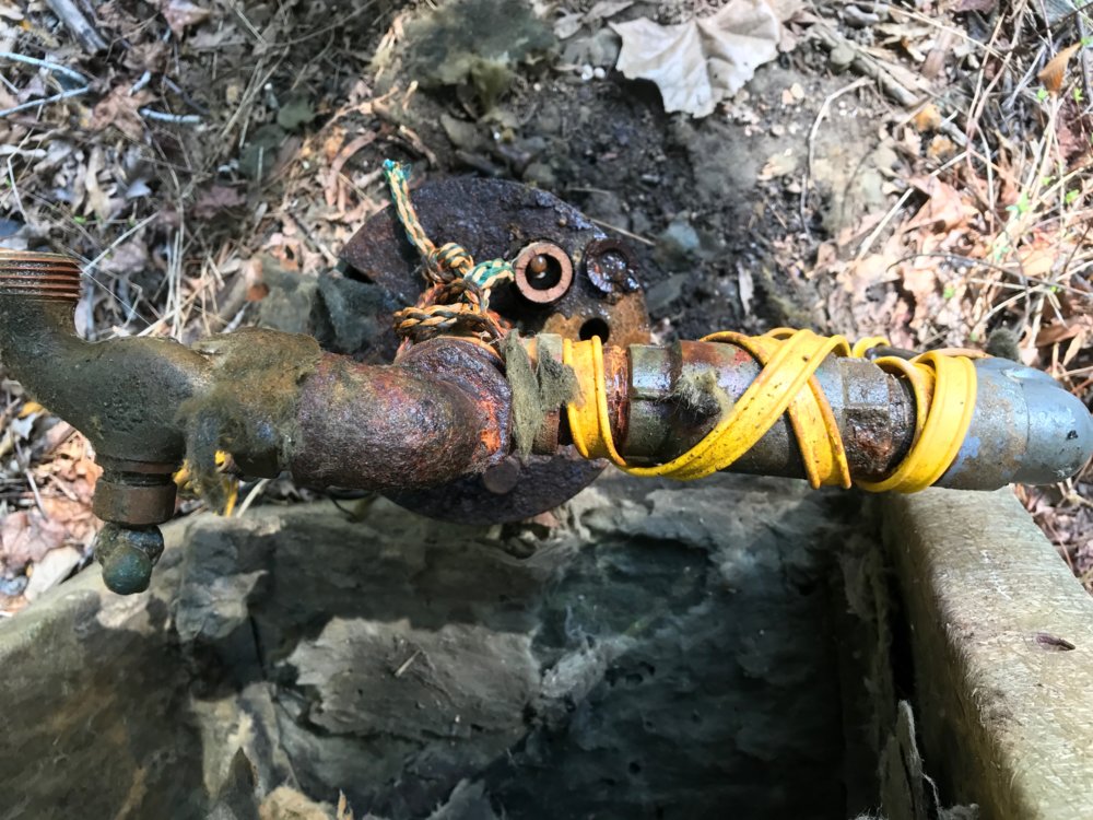

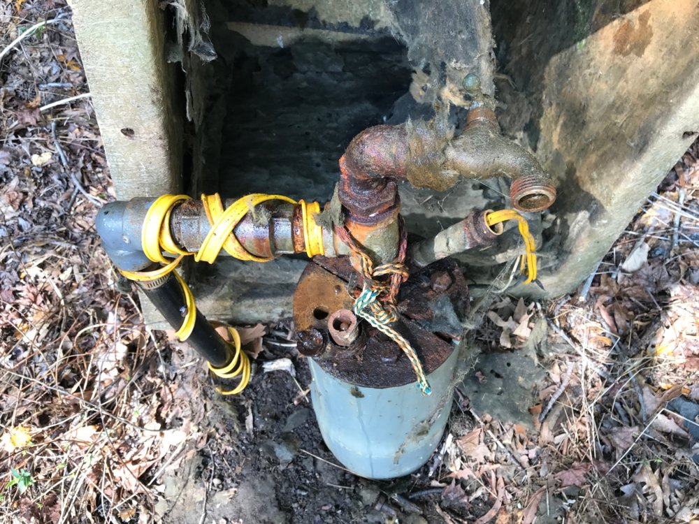

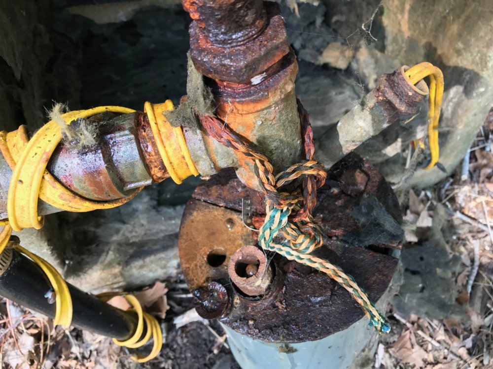

This is the well at our house we just bought. One of the fittings leaks, the electrical is obviously not up to par, and you can see that the top is open, which could let contaminants drop in.
Anyone on here in the Concord area do this type of repair?
Also, I'm curious how deep it is, but don't see any tags. Any other way to find out?
Do I see brass, steel, and pvc all on the same line? No wonder it's leaking. Need some dielectric fittings in there...

looks like the 6" I used to have at my first house, except mine wasn't all rusty. Mine was probably in that age bracket, when the foot valve gave out.
Just what you wanted to hear! Anyway, City water was available, & was a better option, than the Fix.

I had made a set of plates to use to pull well pumps for a plumber buddy, basically a u cut in a piece of 3" 1/4 flat bar with a hole at one end (it had a gate to keep it from sliding out the side of the u)... Add a come along and a place to hang it from and you could take all day to pull it and not worry about it slipping.. you really shouldn't have lift it but a few inches to replace the gland and the tee. Pm sent with my plumbers number.
