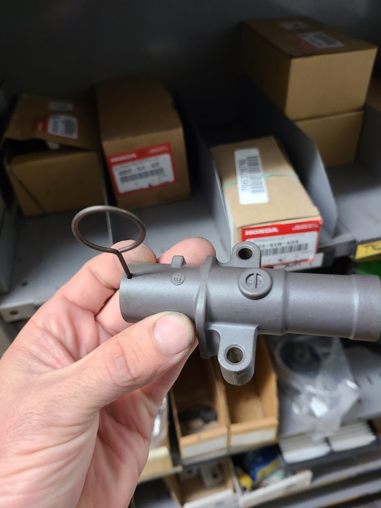

Its the tension adjuster not the tensioner.

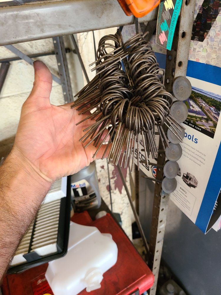

The tension adjusters usually start rattling by 150. I have never seen a belt break before the tension adjust comes apart. I would just get it all done now for peace of mind.
