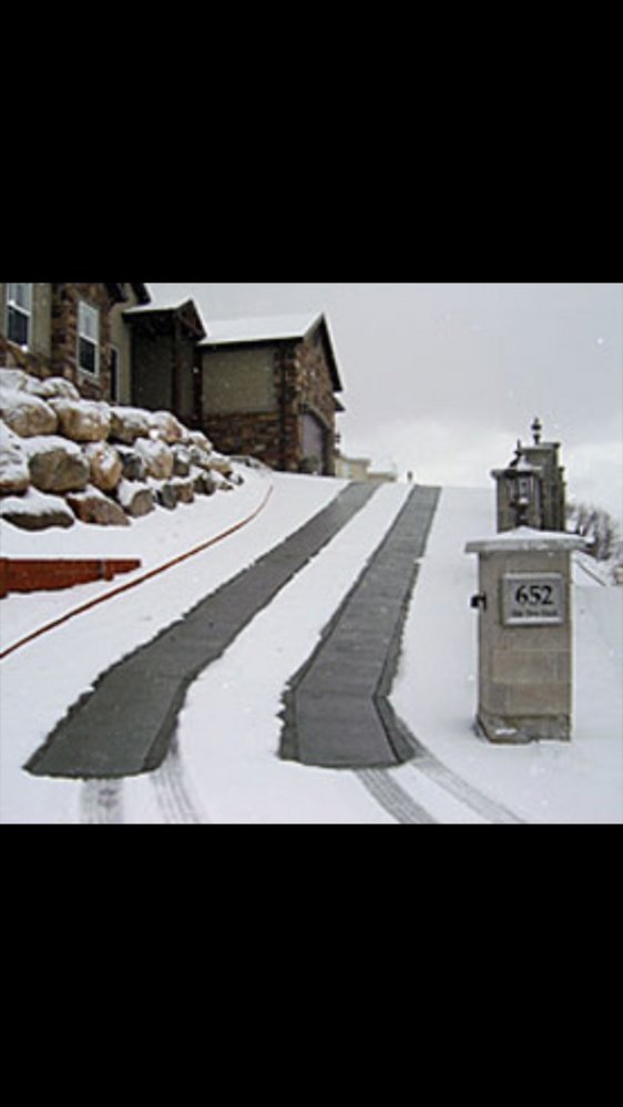

Saw where someone on Google had some sort of snow melting device under theirs?

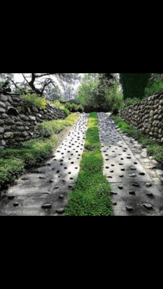

I'm sure there's some unique drives on here. Best I saw so far someone concreted rocks sticking out ever so often like every 8-12". Tedious but definitely accomplishing.

Could just heat where the tires will be and save a few $.
The bottom pic is cool.

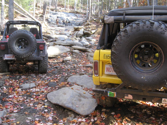

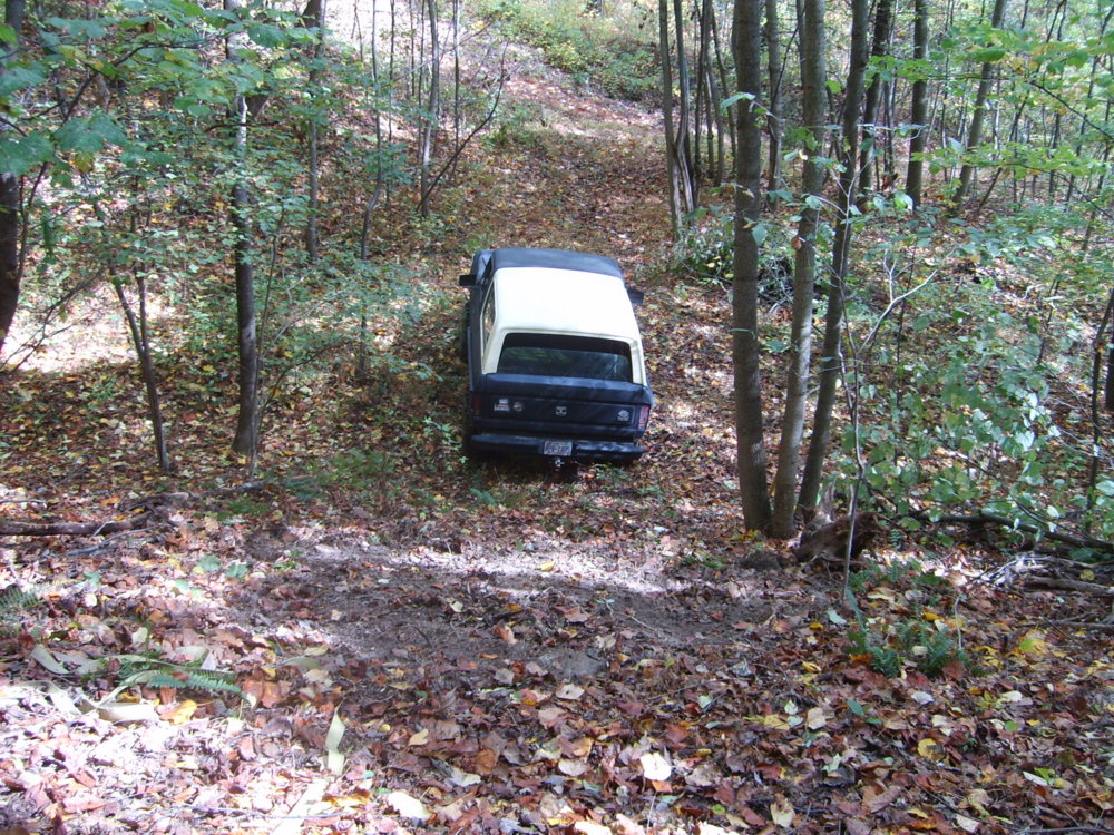

I can drive any rear wheel locked 2wd vehicle I have up it with enough right peddle on any given dry day. Wet requires same with 2 locked axles and good tires. But either way you loose anything not tied down from the dash into the floor.

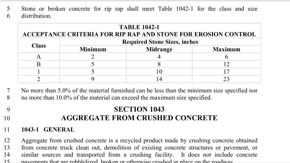

There are different classes of rip rap.
I wouldn't use it as a road base but some construction and logging operations use surge stone to set a temporary base during construction or operations. It's usually removed during final grading.
I'd use good sized riprap in the ditches to control erosion. It does need to be the appropriate thickness too.

I like the rock in the concrete idea best so far for some switch back and just have a dirt trail up the middle.

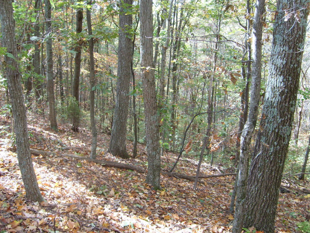

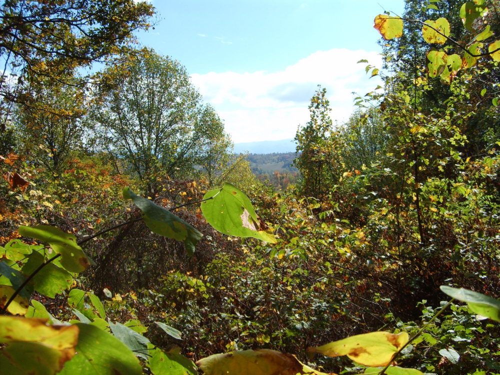

Looking down right where the corridor opens up before the ride down to the right.
