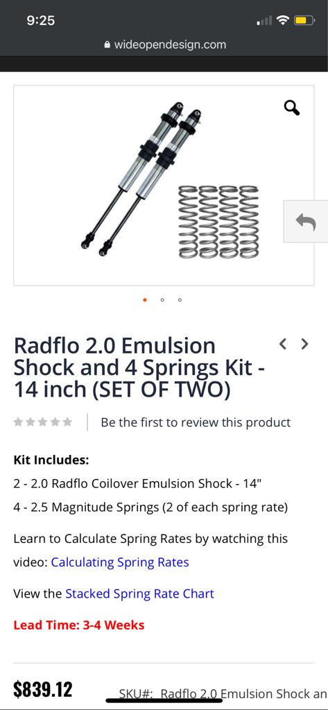

$1700ish for radflo with springs from wide open. Straight off the website.
Nearly identical price to 4 2.5” air shocks.
Being that the price is so close, I’d pick coilovers over the airs just based on the total load (weight) bearing capacity.
that's for 4 correct? do you know anyone here that gets any deals. that's pretty good price there I reckon wich springs and all
$839 for 2 shocks/ 4 springs.
$1680 for 4 shocks/ 8 springs.
Plus tax and shipping.
