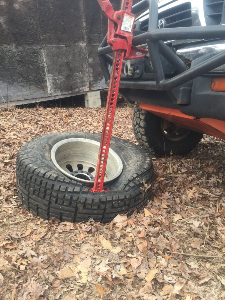

Yeah, all you need to seat and debead tires is a hi-lift, compressed air, and a couple of pry bars. Actual tire spoons might be better, but any pry bar will work.

Hi lift works all the time...

that does sound like work... put the hook of the hi-lift in the receiver of your truck and place the tire under it... take the tailgate off the truck if you care about it. No pry bars needed.

Shoot me a PM. I'll drive over with my truck and a hi-lift this weekend and we should be able to break them no sweat. I have time tomorrow (Saturday).

I swung by Josh's place yesterday afternoon. We (to be fair...HE) broke 8 beads, cleaned a bunch of bead trash out, replaced 4 valve stems and remounted...before 2 of us could kill a 6-pack. Sure...I've done the hi-lift trick on a trail and the cam-strap to re-seat it...but...when a man says he has a tire machine and offers you to swing on by...well...I'd swing on by! Thanks again @karatejosh !!!!!!!!
