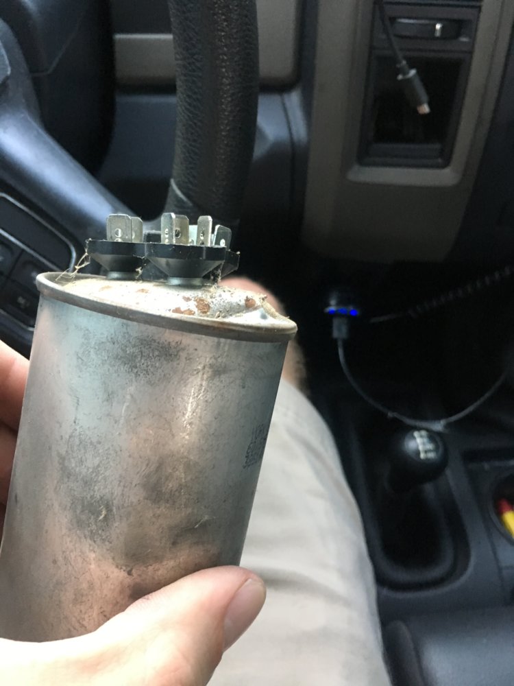

It just isn't cooling I have no idea what's wrong with it I know we replace the capacitor a couple of years ago when it would not come on at all.

There should be two caps - one for the blower, one for the compressor.

Was working fine yesterday. This morning it was a little weak but we had to leave came back to nothing but warm air blowing out of the vents. The lines are all warm.
With the Tstat calling for cool...Fan on on the outdoor unit? If not check your breakers first. If a breaker is popped this could all get alot more fun. If the outdoor fan is on, the HERM side (compressor side) of the capacitor probably popped. Watch yourself a youtube video on how to discharge the cap and take it out.
If a big box store doesn't have the one with the same numbers on it go to your local HVAC supply house with the old one in one hand and a $20 bill in the other and sit them on the counter at the same time. RE Michel usually doesn't give me any trouble if you have one of those locally. I have to use friends' accounts at some of the other parts houses though. I'm not a HVAC contractor, I'm just a dude that has a a refrigeration license and fixes my friends A/C's.
