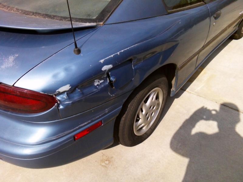

My step-daughter's Sunfire has a REALLY nasty dent in the passenger side quarter panel (right where the gas filler is). I'm trying to figure out how I can repair it cheaply and thought of a Pull-a-part junk yard for a source. The one I've frequented before had three Sunfires on the lot the same generation and if I remember right, at least one of them had a straight quarter panel.
My question is, has anyone ever got a quarter panel or similar large chunk of metal that couldn't be unbolted? If so, what tools worked best for your extract? I have a battery operated sawzall, but even with 2 18 volt batteries, I'd be afraid of not having enough juice. There supposedly are spot welds that can be cut or drilled, but that seems like a VERY time consuming task to undertake at a u-pull yard.
Any suggestions?

I have drilled out spot welds. It isn't fun. The worst part is that when you are done, you have to weld a piece of swiss cheese back together. Think about a 3/8" to 1/2" hole, each 3" or so apart from the next. It gets really time consuming really fast and looks like crap when you are done. Now I use a grinder to remove the junk panel from the good one and do not use any kind of spot weld cutter.
If it were me, I'd hire someone to fix it on the cheap, if you don't have the skills. I do not (for bodywork) and know that it is easier and often cheaper to have someone else do it.
What you really need is a stud welder. The harbour freight one works fine. The steel may be stretched to far and thin to bring back to shape. You may be able to make some relief cut in and amd bring it back out, but no more complex than the panel is in front of the filler door, you could probably just about make a small patch panel if it all works out right. Quarters are a pain. Much easier if you have the car on-hand so you can take your time. But if I'm in a hurry, I usually use a sawzall with a badass blade amd cut past what I know I'll need.

In this case I would def. agree with Blaze and Charles. Stud welder and slide hammer as best you can, pull tail light and inner wheel well, hammer and dolly where you can back there. Weld up any holes and fill it. Cutting out body panels at a junk yard is not fun... never seem to have what you need no matter how well you plan. If you do cut it out, use a cut off wheel, saw will produce waves and spot weld cutter will be a lot of work and possibly a lot of cutters, plus you have to find all the spot welds.

I'm w/ Blaze and others. I'd pull/psuh it out as best you can, then invest in a 5 gallon bucket of bondo. That giant V-crease... Honestly I'd just fill it all in w/ a shitpile of bondo and smooth it out into a new panel.
