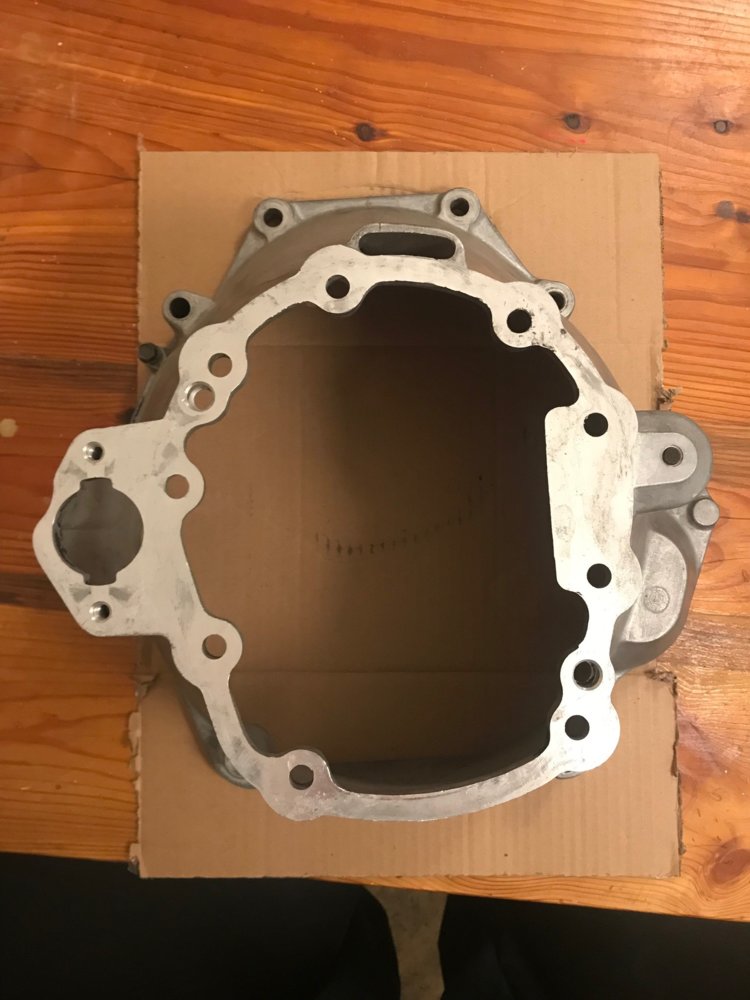

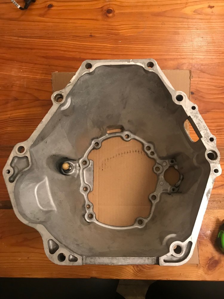

Here is what I have. I'll need to figure out starter hole on the other side but we'll cross that bridge later.
No, I did not have a 2.5(60' pattern) to r150/ax15 'Dakota' pattern, bell-housing.
I switch to the Ecotec motor before i bought a 'Dakota' pattern....
I do have a Ecotec to r150/ax15 bell-housing FS: $200 :)
